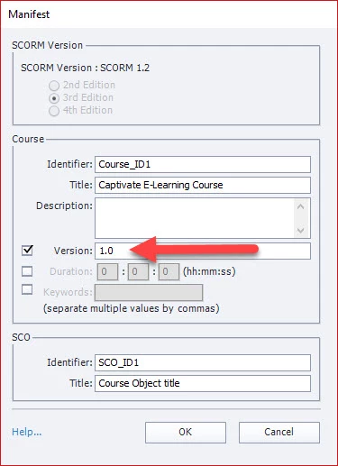

I think this is one of those areas where each LMS and authoring tool has tended to go their own way a bit when "adhering to the SCORM standard".  There's no guarantee they will all behave the same way.
The area I would encourage you to investigate is how your Moodle instance is currently handling any change to the Version field.
I have a sneaking suspicion that Articulate may change this field with every publish, but with Captivate the developer is expected to make this change.  If this field is what the LMS is using to determine whether or not the progress gets ditched then that would explain your differing behaviours.
The problem of course is that if between versions you happened to change something that affected number of Interaction IDs or even their names, then your course reporting would be potentially compromised.  So I think this might be why the Storyline people are preferring to go the safer route of always indicating a version change.  That way they won't get the blame.
