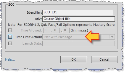

We are now experiencing another issue, however. Whenever our users are attempting to complete the course, they are receiving a "time out" message that closes the Captivate course window. This continues to occur every time they try to complete the course.
Has anyone else run into this problem? Any solutions to this?
Sara
RodWard
May 19, 2012
Check your SCORM settings to see if there is something set for the timeout.
