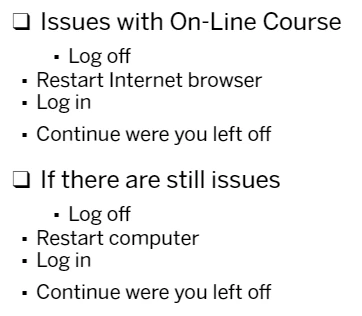

I am using Adobe 2017 ver. 10.0.1.285. When I launch "Preview Project" I have noticed the sub-bullets are aligning with the Main Bullet instead of being indented like the first sub-bullet. What is going on with the mis-aligning? I have verified the sub-bullets are aligned correctly in the project itself.
Thank you

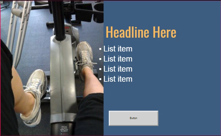

    Curiously enough, I'm having a similar issue. I'm not using sub-bullets, but I am instead indenting a bullet set because I like its style better. It also goes with company branding.
    I dummied up a slide to show an example...
    This is what the slide looks like inside Captivate...

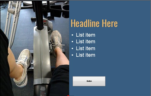

    This is what it looks like in Preview mode...

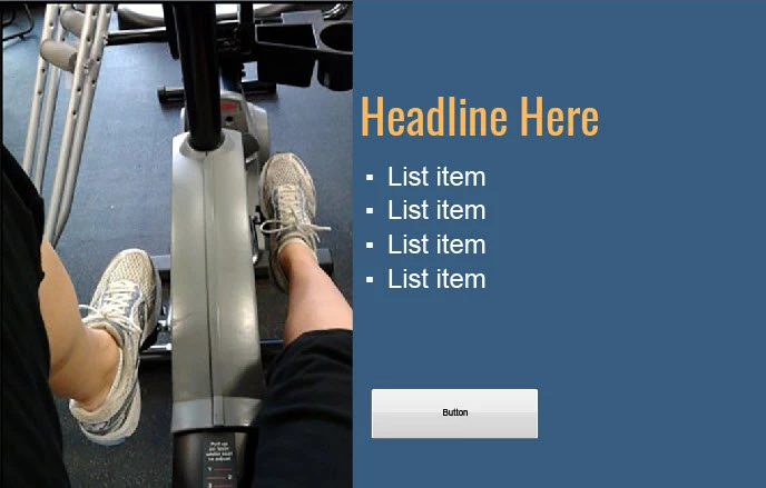

    I copied and pasted the slide into a non-responsive project, and this is what it looks like in Preview mode...
    Furthermore, when I upload the responsive project to our LMS, I get the same result as I do in Preview mode. (Second image above.)
    I even tried using Arial, but I got the same results.
    So, using my very basic understanding of the e-Learning world, it seems to have something to do with the combination of indenting and the responsive project.
