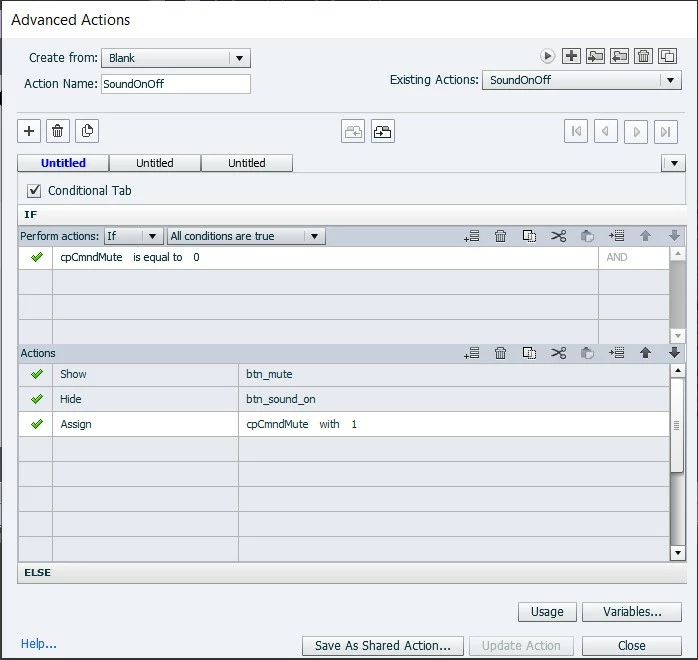

    Please show the advanced action for the Toggle buttons. Hope you did take out the pausing point of those shape buttons.

    Only the audio on/off button has an advanced action. The menu and help button jump to a different slide.
    The questions are based on default quiz master slides but I placed the objects outside of the slide as I use the following slide for the feedback.
    Here the advanced action for the audio on and mute button:
