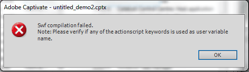

I am using Captivate 5 on a Windows Vista machine. I upgraded from Captivate 4 a week ago and successfully published one project in Captivate 5 before this one. I have compiled the current project a dozen times without a problem. But, when I added the project information and then tried to publish the project, I got the following error: "Swf compilation failed. Note: Please verify if any of the actionscript keywords is used as user variable name." [sic] I am not using variables in this project, so this error does not make any sense to me.
I am able to preview each slide individually. However, I get the above error message when I attempt to preview the whole project. I tried copying the slides, audio, and captions to a new blank project and got the same error when I attempted to publish it. I also attempted to remove all the project information and publish to project with no success.
Any ideas why this may be happening and what I can do about it -- short of starting the project over from scratch?

    I am having the same problem, and thank you for all the responses.
    I think my problem could be too many Text Box Variables (over 100) and/or a TEB variable that actually has the same name as an actionscript variable.

       Had exactly the same problem, but none of these responses were relevant. No project information, minimal text boxes ect. I then started reverse engineering my project up to the point where I found the culprit:
    I had a Text Caption box on a certain slide. Nothing wrong with this right. As soon as this text box contained the text [equals(1,true)]  (Yeah, I needed a text box to show that), then the compile would fail. I then went on to discover that it is the [ ] causing the hassle. If I remove any one of them the compiler is happy.
    Now, my guess is that as soon as you add a caption/text/project information which contains a [ and a ] that the compiler is trying to do something with this.
    I hope this helps if you were still stuck at this point.
    Johan.

    I ran into this very problem today, after opening a CP4 project for rework in CP5.  An important detail in my situation is that the original was created using a corporate CP template.  Apparently, there is a variable or keyword in that template that CP5 doesn't like.  Until I have time to break into that template to search out the bug, I simply:
    1. Copied the slides out of the original project
    2. Created a new CP5 project with the same dimensions
    3. Pasted the slides into it, which throws out the template features
    4. Copied the common/templated objects into the Master Slide and applied it
    After that, I threw out the "widget" page counters, etc. in favor of using CP5 variables.  Less is more in CP5, I've been having great luck with it.
    Hopefully this helps somebody

    Thanks for the information , removing the " from the project information area
    allowed me to edit and publish a CP4 file in Captivate 5. I was about to uninstall
    the app and be done with it.
    Man I wish Adobe was more forth coming with this type of information for their loyal customers.
    ** At first I copied all slides to a new project , which did work , but only due to the Project Information not being copied along with the slides **

    My guess is that this error occurs when certain characters -- which are as yet unknown -- are used in a Captivate project. In my case, the use of double quotes (") in the project information box is what caused the original and subsequent errors (even if they were not cut and pasted into the project). I now replace double quotes with single quotes (') and have not run into and Swf compilation failed error since.
    Reading over the messages in this thread it appears that other people's errors are similarly caused by character conflicts (for lack of a better term). These conflicts are highly complex and no one has a complete list of the problematic characters and the situations in which they cause conflicts, but they are a common thread in most posts. Someone who knows more about computer programing may be able to pinpoint what all the problematic characters have in common. It will likely be a set of simple characters and code imported into a project with cut and paste.
    Hope this moves the discussion forward.

    I'm able to reproduce the issue with double quotes in the project information dialog. Thank you for helping us to repro the issue. I suggest you to file a wishlist bug at https://www.adobe.com/cfusion/mmform/index.cfm?name=wishform&product=5

    I had this happen as well and here is what I did to resolve the problem...
    I guessed that it was due to a text entry box that I gave a custom variable to. I went through them and renamed any that I thought actionscript may own. I had one that I labled "keyss". I think this was the bad guy. Due to using the same environment as my template I had many different variables saved in my project. I just cut and pasted it into a blank new document after changing this variable. And republished. Keeping my variables cleared up seemed to work for me. Good luck!

    Okay, I came across the same error for 10 quizzes that I built using Captivate 5 that compiled brilliantly until I added reporting when only the first quiz compiled correctly and the other 9 came up with the same error.  I had copied and pasted the course titles from an excel spreadsheet (which were in uppercase and I used Proper() to convert to proper case).  When I copied the results (it must have also copied part of the function).  At which point the compiling failed because Proper() was not defined in my swf code.
    The moral of the story is be careful what you copy, even if it displays as simple text, there can be code behind it that it reads.  I am not saying this is what the others here are experiencing, but it is what caused my Captivate quizzes to fail to Publish.

    ON EDIT: I was able to see that my Java runtime environment was not setup properly.  I removed Java then re-installed the 64 bit JRE.  Now I can preview, without getting the error message we were getting,  but the actual SWF does not load, so it acts like it is pre-loading...forever!
    I'll update further ... I'm (hopefully) getting close to a resolution.  I had an Environment Variable for Java and I think I need to set that up again.
    ON FINAL EDIT: Problem resolved!
    I had to remove the JAVA_TOOL_OPTIONS environment variable (that Flash told me to add when I tried to launch Flash for the first time).
    All the Captivate files I had created before messing with the JRE, I will now need to re-create.  For some reason, the files I created during my JRE issues prevent the movie from loading...
    So for me, it was a combination of 64 bit OS, doing what Flash told me to do (adding an unnecessary environment variable), and possibly having the incorrect JRE loaded too.
