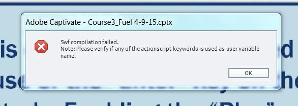

I am getting a SWF Compilation Failed message.  This happens when I add a pretest to my existing Captivate file that has a graded test.  Everything works fine until I add the pretest.  Once I add the pretest I will get the error even if I delete every slide except 1 simple text slide.  Can anyone help me figure out what is going on.  You can download versions of the Captivate file at the link below.  One is the file before the pretest is added and one is after the pretest is added.  So Frustrated.

    Hi Dan,
    I can see that you have applied some playbar widget in Captivate. Can you try to remove it and check again?

    April 9, 2015
    Im fixing a project done by another vendor.  I copy and pasted into a new blank project and it did the trick.  Must have gotten rid of something bad like that widget.
