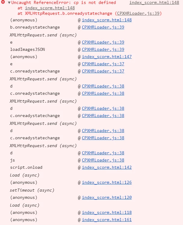

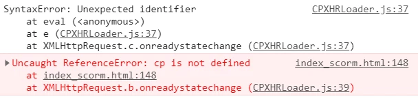

Syntax Error, project won't load
My team has been working on a project in Captivate 2019 (11.5.1.499)
We have been testing the project (HTML publish) locally on our machines and everything works fine, but when we try to upload to the web, we get a weird syntax error in the CPXHRLoader.js and a reference error in the index.html "cp is not defined", and the project won't load.  I confirmed that the CPM.js is in the proper folder. It's just weird that it works locally but not online. (I also tried on multiple computers/browsers to make sure it wasn't a firewall/network/browser issue) Has anyone encountered this?
