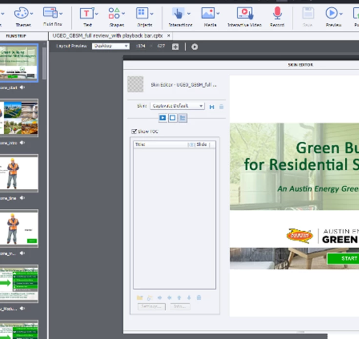

Nothing is showing up in the Table of Contents following the generating TOC instructions. What am I missing?
Using the "Project"drop down and selecting "Table of Contents"
Then click "show TOC" box and nothing comes up
I have master slides and I've tried grouping and ungrouping my 4 modules. I do have slides imported and edited from different themes. I tried creating a custom theme and it results in a "fatal error". There are 123 slides total with a knowledge check/quiz included. My goal to get the playback bar to work otherwise this training works fine in our LMS. This is my last piece.
I'm at the final stage of launching this training so any help would be appreciated!

    @Paul Wilson CTDP  Sorry, but Resetting TOC has nothing to do with this. There is NO slide visible in the TOC. It is impossible to have a project without at least ONE slide. Even if the TOC is created from the start at least ONE slide should appear. There is a screenshot, did you look at it?

    Thanks for jumping in Paul. Yes Lilybiri is correct, there are no slides showing.
    When I click on Settings or Info in the Skin Editor I get a fatal error message and the program terminates. On a separate copy, I've tried to save a custom skin and get the same result - no slides in the TOC. I've also tried to convert all the slides to one theme and the same fatal error issue happens. When I try to preview, the slides generate, and a browser window opens but it just keeps loading.
    Before I tried to get the TOC created, previews worked great, no fatal errors, and all the content worked.

    Can you please tell the exact version number you are using presently? Look for the full number under Help, About Captivate.
    It looks like you are on 11.5 because you are mixing multiple themes which is only possible in that version. But which version of 11.5.
    Master slides have no link with the TOC. In the TOC only normal slides should appear with their Slide name (if you have one) or the Slide number. If you have grouped slides, you'll get two levels in the TOC, but the group name cannot be used for navigation.
    TOC setup is part of the Theme, so the TOC will revert to the setup of the theme for the active slide, if you are using multiple themes. I would be very careful with such a setup.

    Yes 11.5.1.499
    This is what I see....

    It is a responsive project. You cannot have the TOC as separate, it needs to be in Overlay. What appears in Preview? Did you mix multiple themes?
    You are not using the most recent version, which is 1.5.5.553 for Windows. Please update ASAP.
