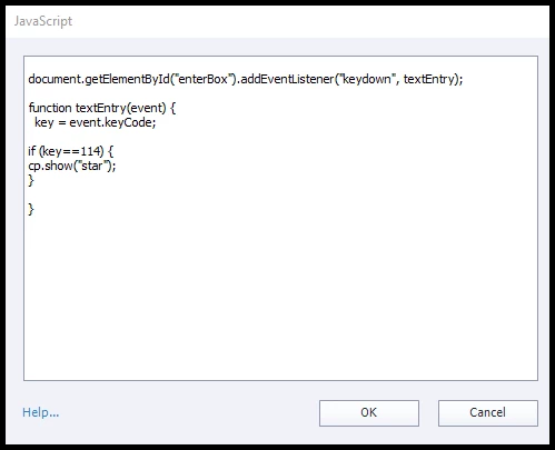

    What if you try something like this...
    The question is - what do you want to have happen when the user presses F3?
    In the script shown below - we add the listener which calls the function each time a key is pressed.
    The Key Code for  F3  is 114 so we can then include an if statement within the function that is called each time a key is pressed such that if our variable equals 114 to go ahead and do something.
    This code assumes a TEB with the ID of  entryBox and a Captivate variable called key.
    This is placed in the on Enter action for the slide.
