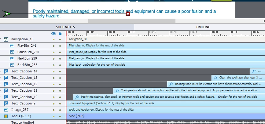

text captions / smart shapes not appearing per timeline in html
Hi, I hope you can help me. I'm having trouble with my text captions and smart shapes not appearing when I have them scheduled to appear on my timeline. There are no pauses on the timeline. I am completely stumped. Does HTML not allow bullet-by-bullet animation?

    I don't see any pausing point because there is no ineractive object. This muts be an old version because i don't see the possbility to expand the effect timelines. Can you specify the exact version number as mentioned under Help, About Captivate?
    How did you test?  After publishing to HTML or in Preview? If it is Preview, which preview method.
    Pausing points on a Drag&Drop slide exists but is not visible.  I suppose this is not a D&D slide.

    I'm using Captivate 2019 (11.5.1.499).  I removed pause points to try to get the text captions to appear. I have the same issue with smart shapes filled with text. On the screen, I have navigation buttons, a glossary button, and a return to quiz button that is hidden unless needed. I have other modules that I developed about a month ago that work fine.

    Oh, I didn't answer the rest of your questions. The captions don't appear when in HTML, but they do appear when I use view next 5 slides, which I suppose is more of a SWF (flash?) option. Assuming that this is going away, I was trying to see what works with HTML. Thank you so much for your help! I have read so very much of what you have written!
