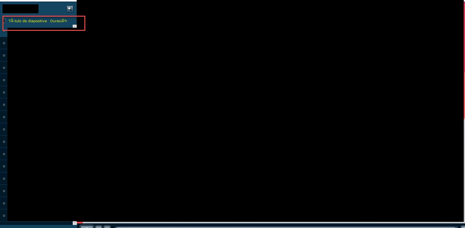

I have got issue in TOC text in my Build, After i done formatting from English to Spanish Language.

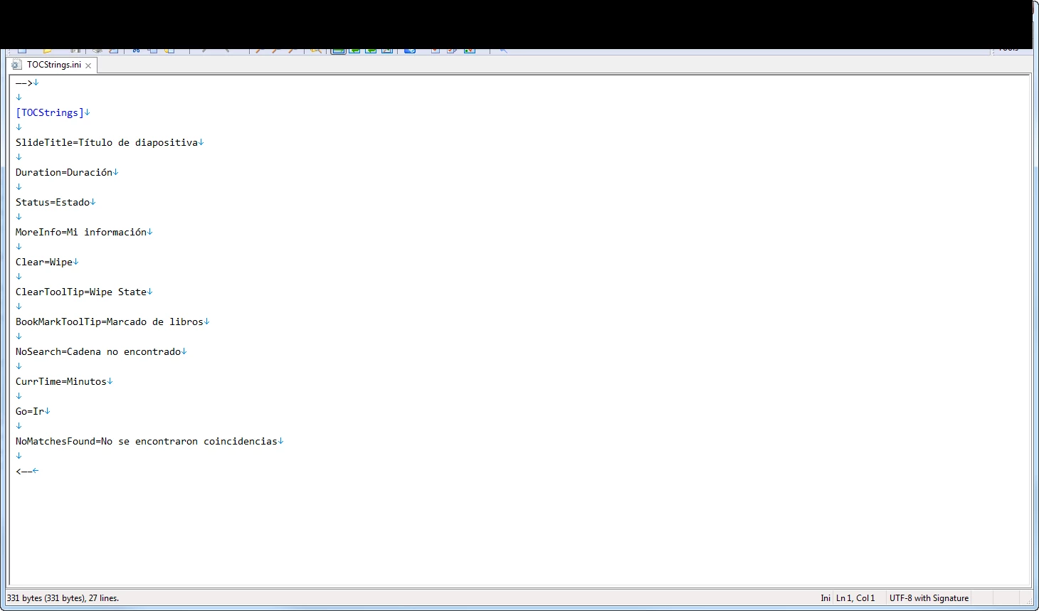

I have make "TOCStrings.ini" in spanish language and placed in captivate program folders.
All text look fine in .ini files.
But when i publish my build and upload on SCORM CLOUD its look corrupt, see screenshot (Red highlighted part)

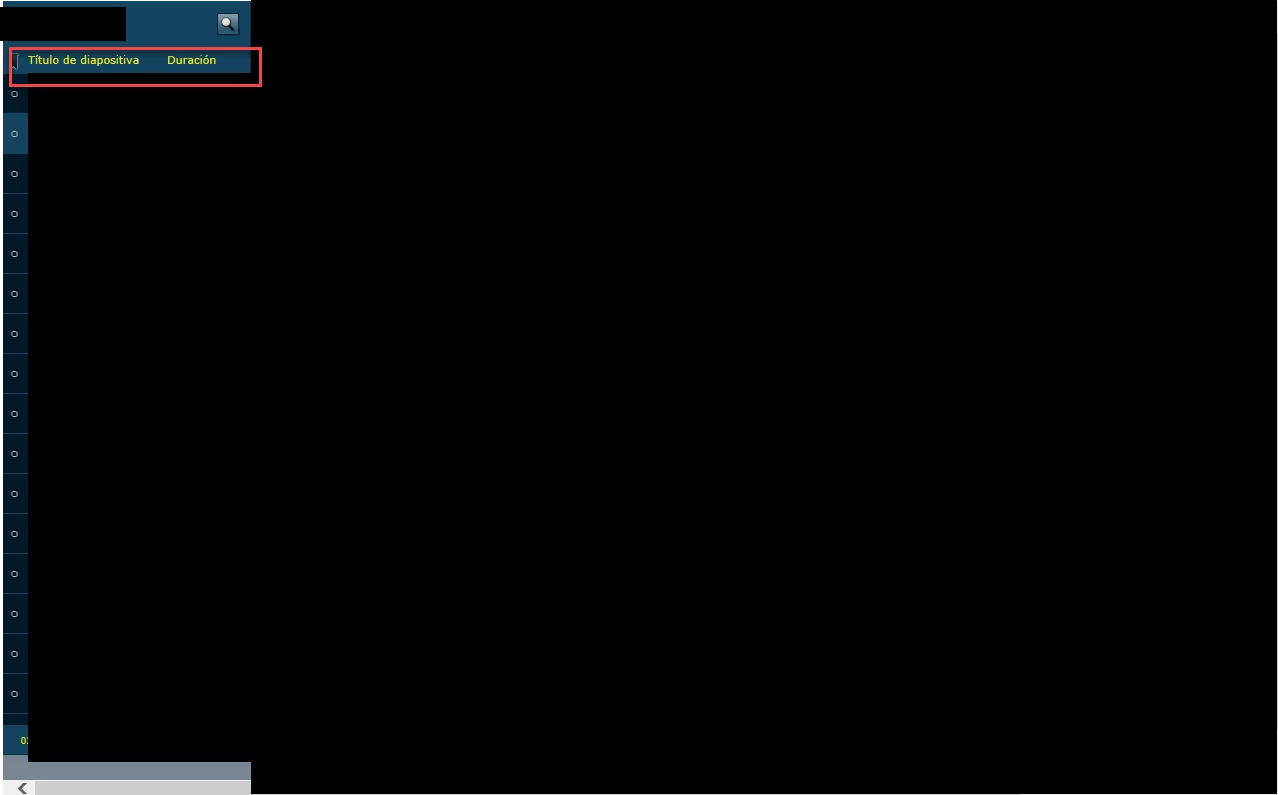

But its look fine when i run course in offline mode, See attached screenshot.
I did utf 8 to .ini file, also made changes in "CPM.js" files, and run build but still same issue on Scorm Cloud.

I'm also wondering if part of the issue might be that you had set the text encoding to be UTF-8 when the font proclaims itself to be Unicode.  Have you tried changing either the font to just a normal Arial, or else changing the .ini file to Unicode?

Its work now after we have .ini file to Unicode. we have kept same font "Arial Unicode MS" cause its support other language too
before we just saving our file with "UTF8 with signature" or "without UTF8 with signature", because most of time its work.
