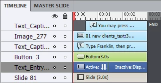

I forgot to show you what I'm doing!
They're supposed to type "Franklin" into a text entry box. Button_3 is a help button to show a hint. The text entry box that is highlighted is the one in question.

I have tried to reproduce your problem and was able to see the same. This means you probably bumped on a bug.
For me the tab (and I verified Seamless tabbing) is not going to the Submit button (didn't you uncheck the Show button in the TEB properties?) but to the Hint button. BTW I hope you used a standard action with that Hint button, otherwise the playhead will be released and ignore the pausing of the TEB totally. http://blog.lilybiri.com/why-choose-standard-over-simple-action
When replacing the shortcut key by Enter, everything works fine. It is only TAB that causes issues in HTML-output, not in SWF-output.
