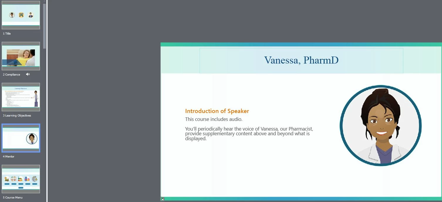

When I open a module, the text or images are not showing on the main slides, but they show up in the thumbnails. (see pic).   I have to click on all the placeholders on the slide for them to show up.  I have to redo, every time I close and open the course to work on it.
You can see thext You can't see the text
Thanks for your help!

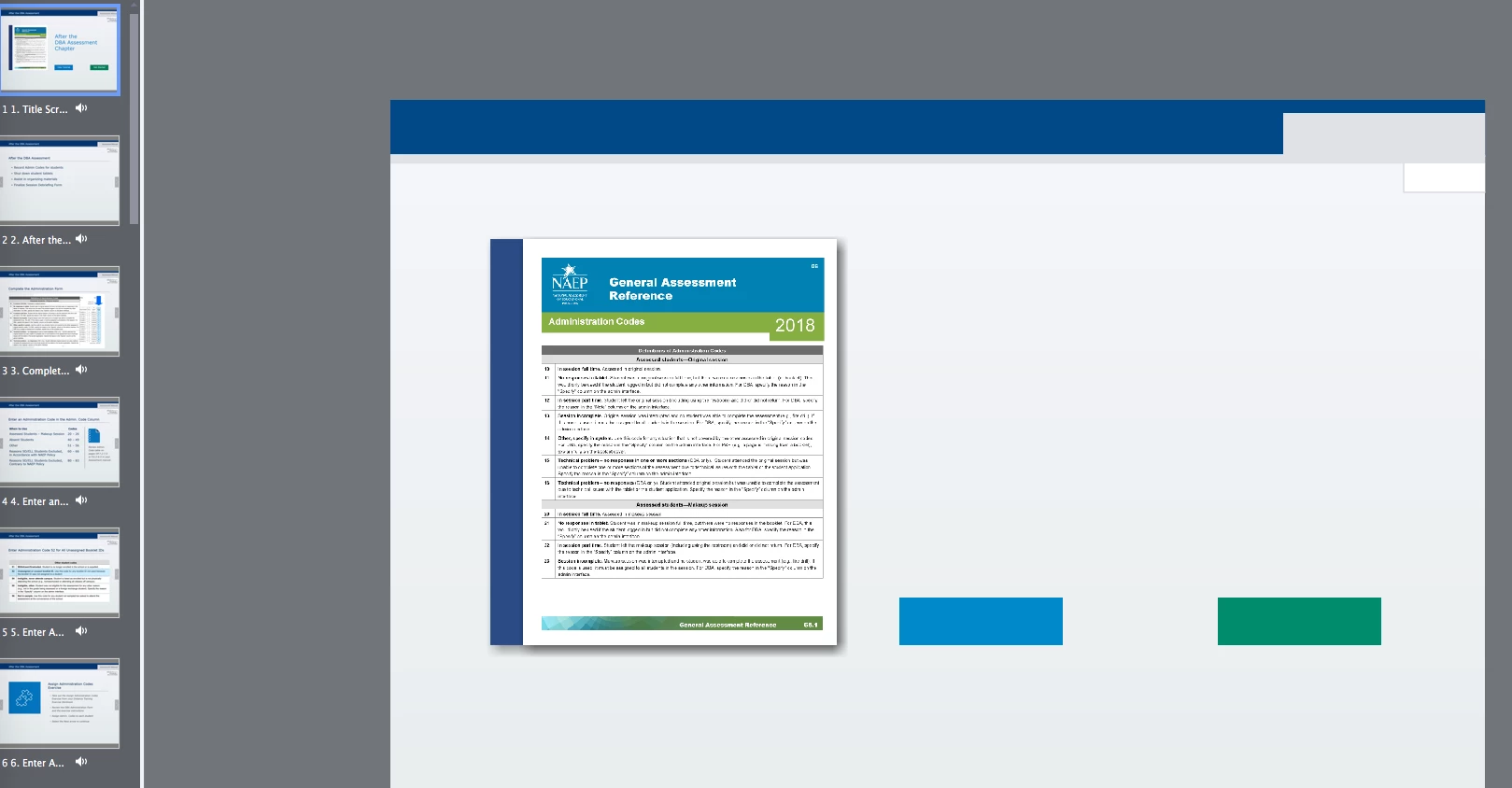

    I am also having this problem for the first time in 3 years of working with Captivate daily. I'm on 2019 11.5.1.499, Windows 10, and this is a corporate license so to head off any suggestions about releases, I am not able to upgrade to any new release. I created a new project from a template in the Discover (eLearning Bros?) section as you can see, and added a few slides, assets and text. Now I must click on each block of text for it to reappear on the slide. I thought it was an internet speed issue at first, but leaving the project open for an hour did not make a difference. This has not happened with the previous 20 projects I've built and delivered, so I'm open to suggestions, but please know that I'm not a novice to Captivate. My project file is on my desktop, same as all previous courses while I work on each one. After completing a project I file away the project files onto our network for storage. I also cleared my cache an it did not make a difference. Thanks in advance for any additional suggestions other than 'build it all over again' because I have a storyline license as well and might prefer to rebuild it in there if I need to start over. 🙂
