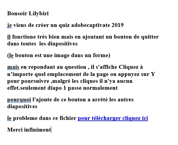

Good evening
I finished  a quiz adobecaptivate
But I added in all its slides the close button is a shape with an image inside, but adding the close button made the transition between quiz slides impossible, how can I add that button without affecting the effectiveness of the quiz
Thanks
