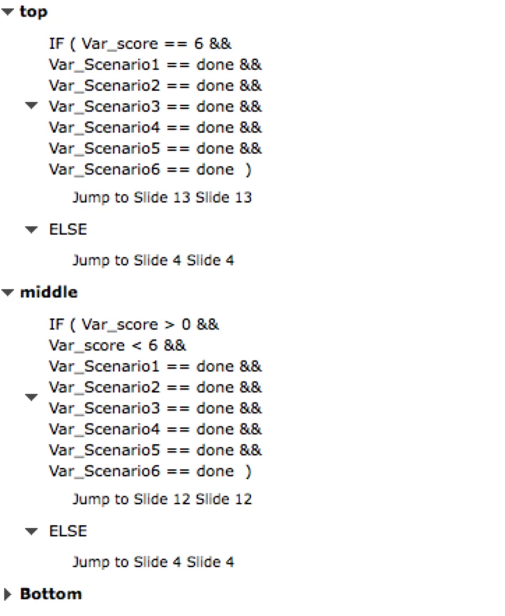

Hey here is the preview of it...
I've not collapsed the final decision... so it all fits in one screen shot. But it's identical to the last two other than it jumps to slide 11 if all the conditions are true...
Sorry for the delay I had to go back in and re-create it as I found a different way of achieving what I wanted to achieve.
Interestingly, I've never looked at the preview before and I've noticed that the symbols used to represent 'equals' and 'AND' are the same as those used in Javascript (just learning it at the moment).
Anyway would love to hear your thoughts around why the 'ELSE' was breaking it.
Thanks
Lilybiri
LilybiriCorrect answer
November 2, 2016
Only the last ELSE will ever be done, not the ones in the first decisions. If none of the conditions is met, the user will be navigated to the slide indicated in the Bottom decision. This is due to the fact that Captivate never jumps out of a action but evaluates everything in sequence. Take out the ELSE parts, except eventually for the last decision. It is logical, will try to explain:
  • If Top condition is OK, user gets to slide 13
  • If this condition is not met you think that user will get to slide 4, but that is not the case, because CP continues and
  • goes to the Middle condition which could be true if Top is not true, if it is true user goes to slide 12
  • if Middle is not true, you think it would go to slide 4, but CP continues
  • it could be that Bottom condition is met if neither Top nor Middle is OK, then it goes to?
  • if also the third condition is not OK, it goes to?
My proposition was to add a 4th decision which will be when none of the 3 others are met, or put that i the ELSE part of the Bottom decision. ELSE in first two decisions makes no sense. You also have to be very sure that all conditions are mutually exclusive, this is the case for Top and Middle, don't know for Bottom.
