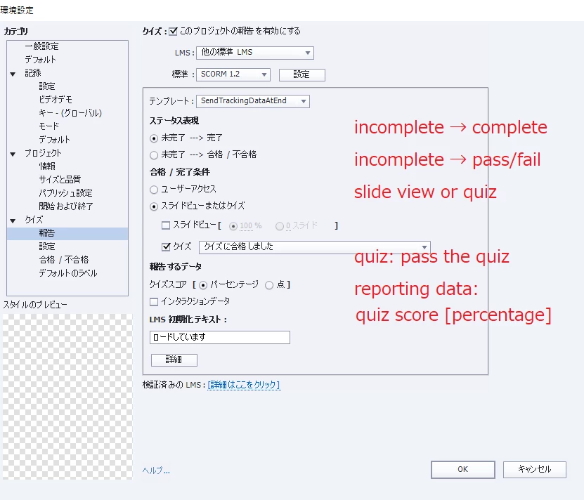

Please show screenshots of your settings under Quiz > Reporting and Quiz > Pass or Fail.
fsxrubAuthor
November 6, 2017
Hi RodWard

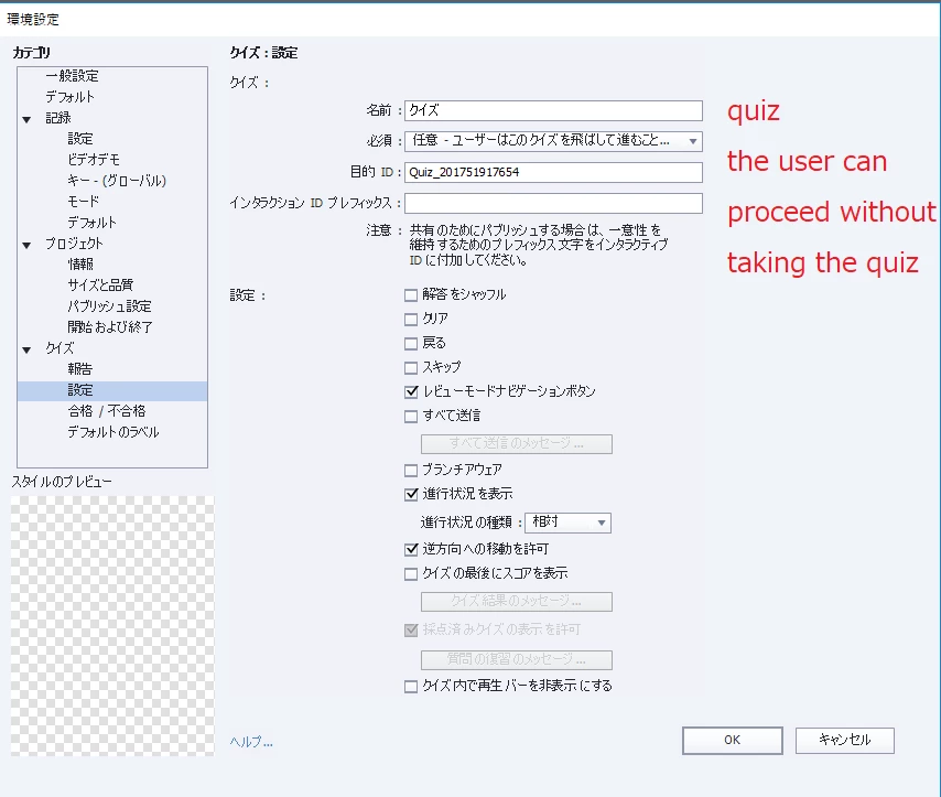

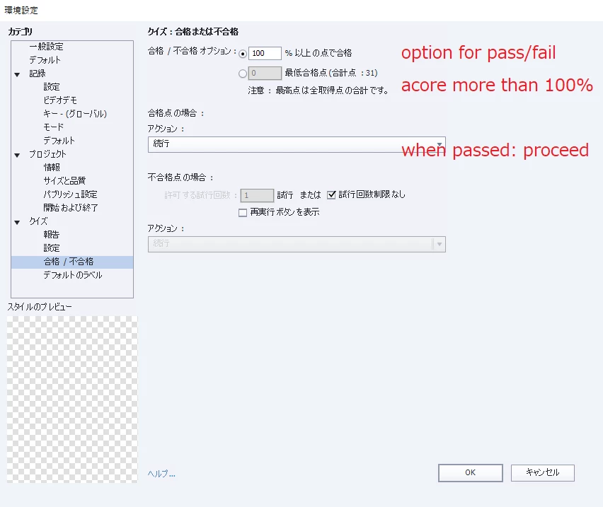

These are the screenshots of my setting pages.
Did not attach them because my Captivate was in Japanese.
I am using the 2017 release.
Are these helpful?
I have tried to indicate the English align with the Japanese words.
(Not sure whether they are the accurate terms because I have not used the English version before.)
Thank you in advance again!
The reporting page.
The quiz setting page
The pass/fail option page
RodWard
November 6, 2017
The settings appear fine, though I often find with some LMSs that you need to set the Status Representation to Incomplete -> Passed / Failed rather than as Incomplete->Complete as you have done.  But this would not affect SCORM Cloud.
Have you checked in the Project > Advanced Interaction dialog to make sure there are no other scored objects reporting to the quiz except the one right at the end of the module?  (If other objects are also scored then this would throw out your results.)
