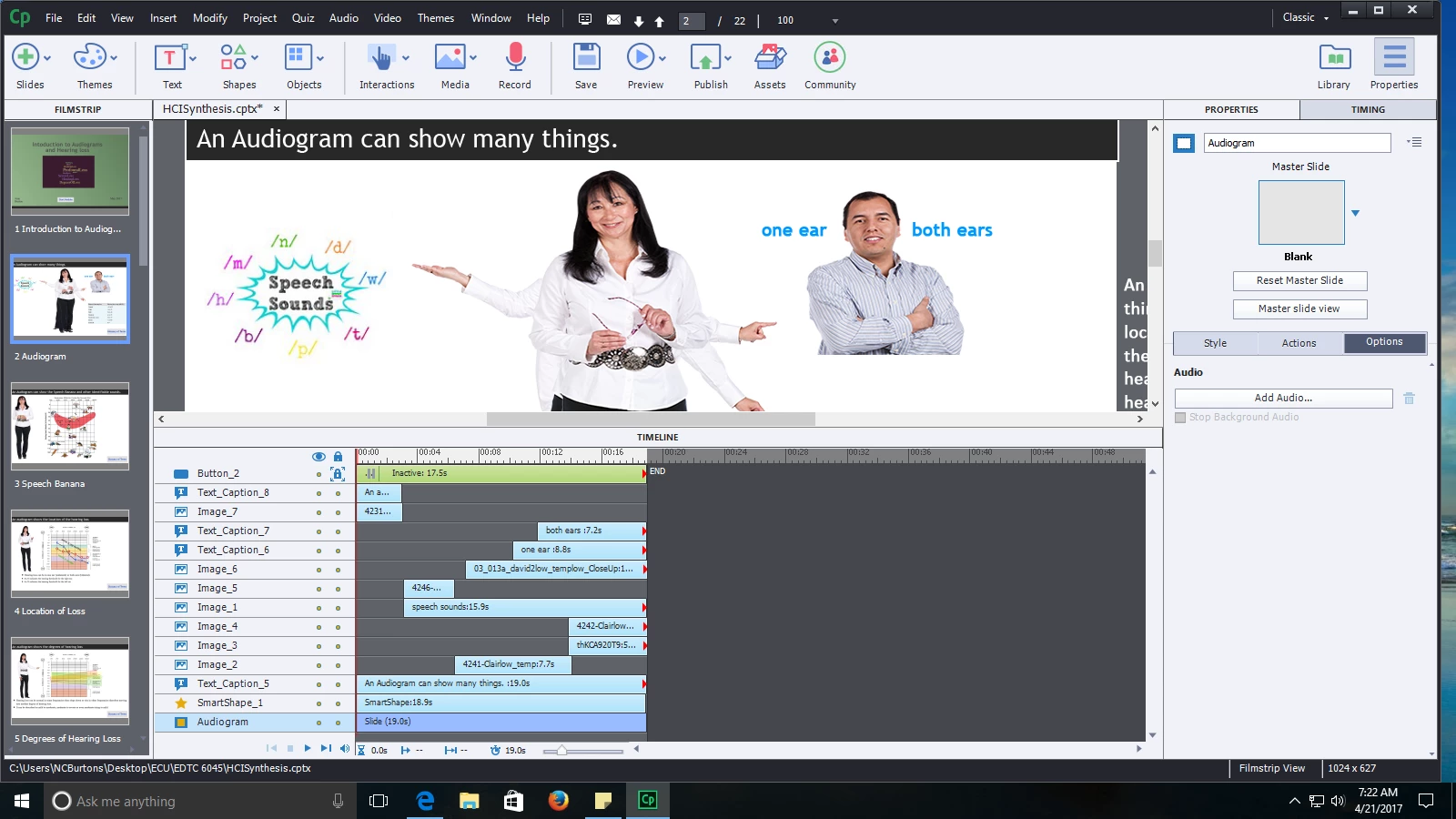

    Can you post a screenshot of the timeline, please. As thousands of other users struggle with pausing the timeline, I suspect a similar problem here:
    Pausing Captivate's Timeline - Captivate blog
    The Playbar from the skin (I can only suspect that you mean that by 'progress bar' which is part of a playbar) should automatically appear from the start, unless you hide it yourself with the appropriate command.

    Right now the audio is not on there because I got frustrated. Where should I add the audio? to the options tab or the actions tab? To the background or an image? Thank you so much!! I an in the east coast, so I have to get to work, but plan to work tonight. Any and all feedback will help tremendously!

    You did misunderstand! No need to have the user click the Play button at all, move the pausing point of the button towards the end of each slide!
    Please, tell me what you are using those buttons for? What is their functionality? Do they have to  pause the slide?
