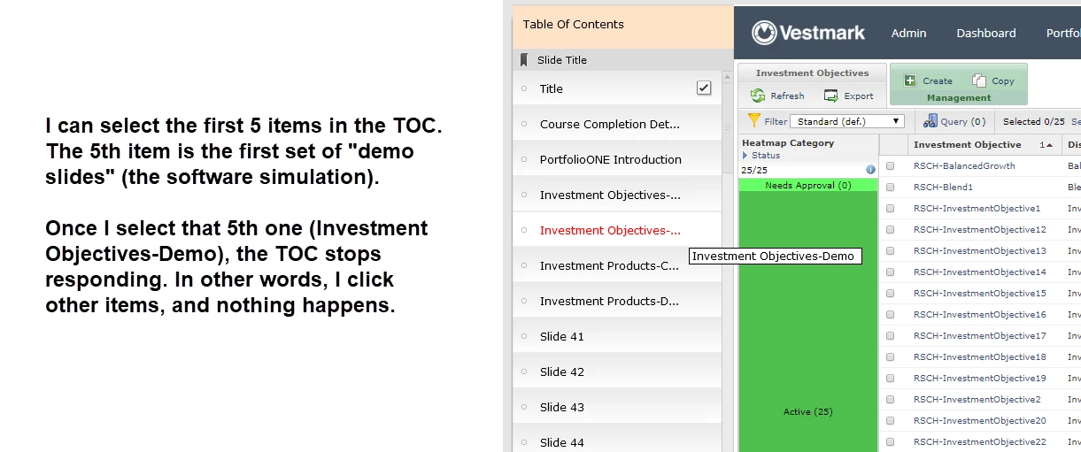

I have a project in which I'm inserting (copying/pasting) "simulation slides" among other slides in the project. This seems to work just fine. What’s stumping me is the TOC. It seems like I can’t have TOC targets that fall anywhere within sets of simulation slides, not even the beginning of them. For example, in the TOC below, I can select any of the first 5 items. But the first demo slide (Investment Products-Demo) just won’t respond to navigation. Nothing happens. I could imagine that there might be a limitation where a TOC just can’t interpret between concept slides and simulation slides.
If that’s the case, I’m thinking that I would need to insert landing pages for all the places in the course where a simulation would begin. But I'd be surprised if that's what's really necessary.
Maybe there's some setting on the simulation slides that getting in the way? I have clickboxes on them (not surprisingly) with the "Pause project until user clicks" option checked, but I don't think that should matter. And I've tried unchecking that with no different results.

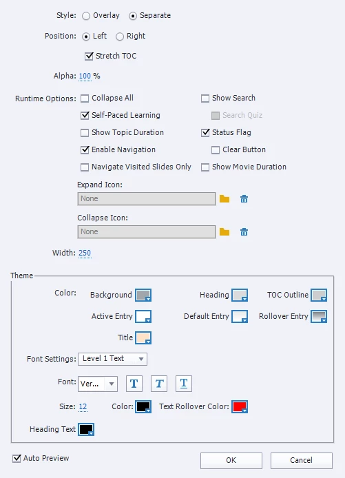

Though I’m still slightly confused. The TOC setting “Navigate Visited Slides Only” was unchecked. Now that I have it checked, I can at least go back to previous slides, even if I’m in a software simulation.
What’s confusing me is that I would have thought that by having this unchecked, I’d be allowed to navigate anywhere, visited slides or not. But that doesn’t seem to be the case. When I have this unchecked, I can still only go back to visited slides. I guess that’s OK, though it might be nice to have the option of jumping around, especially if you’re just reviewing the course. Am I still missing something?

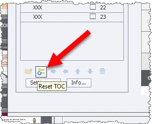

One thing you need to remember about the TOC is that you need to reset it again if you've been moving slides around or adding/removing slides.  Look for the small icon near the bottom of the TOC view in Skin Editor.
The TOC does not automatically update itself after you've made changes.  So resetting the TOC is just part of the editing process.  Otherwise its behaviour can seem very random.

The problem is that I'm unable to select any slide beyond the first simulation slide in the TOC. Nothing happens. I'm starting with an entirely reset TOC, so everything is in order, and every slide is selected. There are some click boxes on the simulation slides with "Pause project until user clicks" selected, but I've tried unchecking this with no difference, so that's not it. I don't have "Navigate Visited Slides Only" selected; my TOC settings are exactly as in the first image in this thread.
