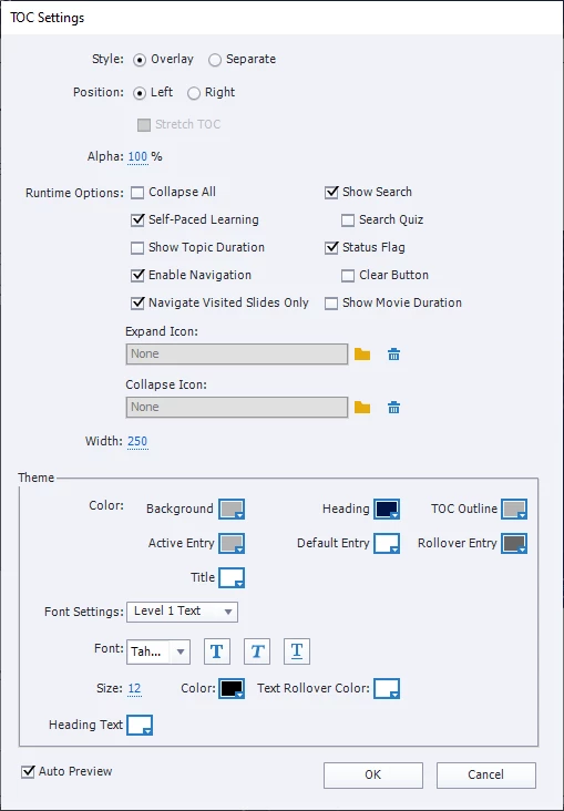

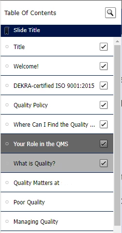

I have a course on an LMS that uses a TOC set to Navigate Visited Slides Only. This works as advertised as long as you are in the current session. We just discovered that if you exit the LMS and return, the TOC correctly indicates the visited slides but they are not selectable. My TOC settings are shown below, along side the TOC. In the TOC example below, the first five slides were viewed in the previous session. The Rollover state does not show nor are those slides selectable. I don't think there is anything I can change in the TOC Settings. I'm using the default LMS Advanced Settings. Hoping for a solution from the community as I have several courses set up the same way.

Not sure if this will turn out to resolve your issue but Captivate has two different types of bookmarking. Having both bookmarking methods turned on at the same time can lead to issues.
When using an LMS, Self-Paced Learning bookmarking should be turned off.  Your screenshot shows it is still turned on.

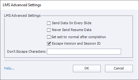

Can you show us your settings for LMS Resume Data bookmarking?  It's under the Quiz > Reporting > Advanced button.  The Never Send Resume Data checkbox should be unchecked.

Never Send Resume Data checkbox is unchecked.
