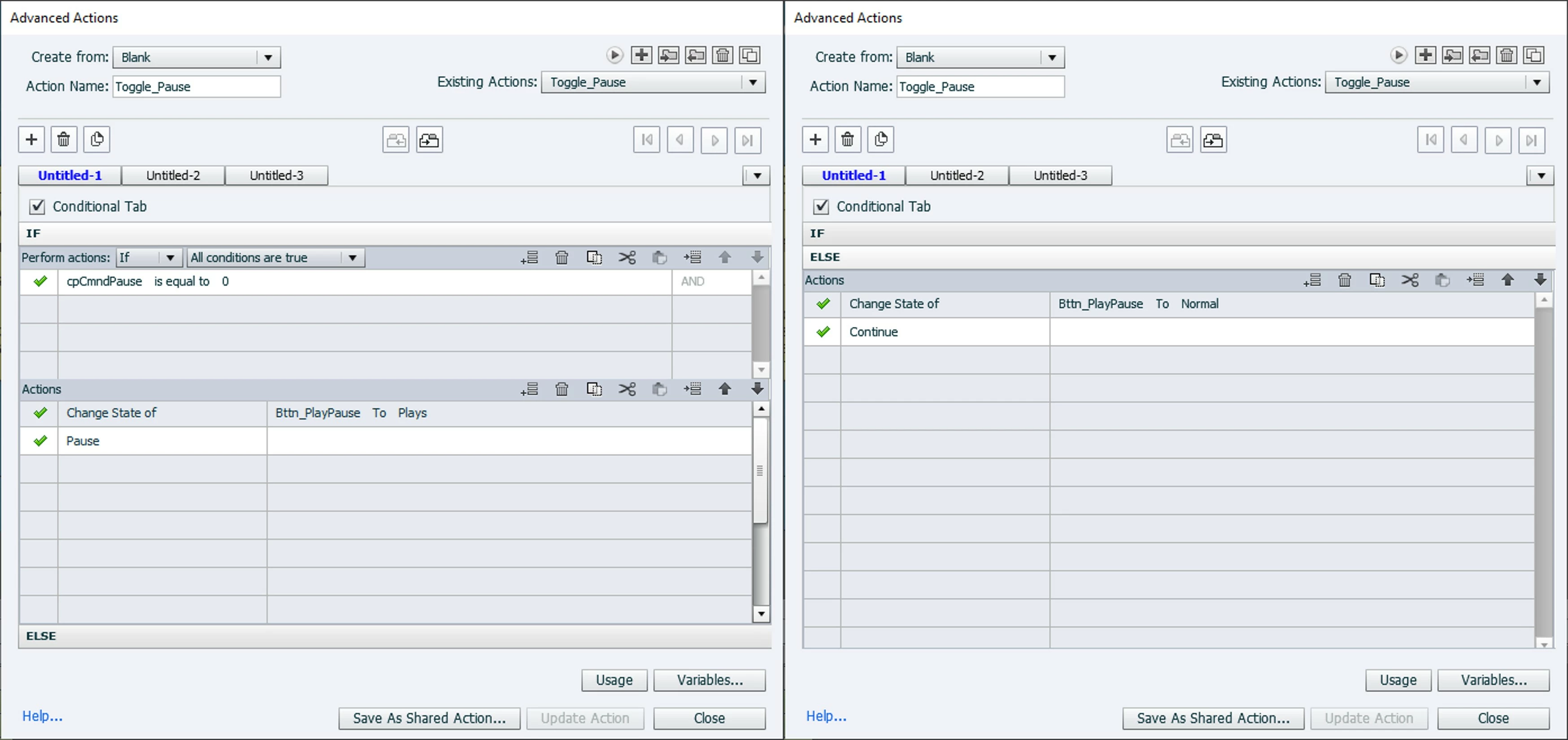

TLCMediaDesign helped me sort my issue with the CC and TOC buttons. Here's my scripting for my Play/Pause button. It's a two-state button (pause and play) that toggles the button state images and pauses and plays the timeline. It's functioning as it's supposed to but the unwanted result is that when toggling from pause to play, it continues the timeline if the timeline is already paused, either for an interaction or at the end of the slide.

B_P_HAuthor
Feb 23, 2022 9:31 PM UTC
Thanks again @TLCMediaDesign  - this works perfectly. The only thing I wasn't sure about was the Select Window drop down. I used Current Window. The only other thing I had to do was add a line to my default slide on enter script to change the button state to normal because if you click that button it will still change the state - but it doesn't advance, which is what I needed.
