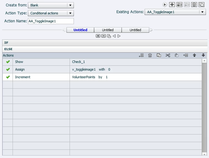

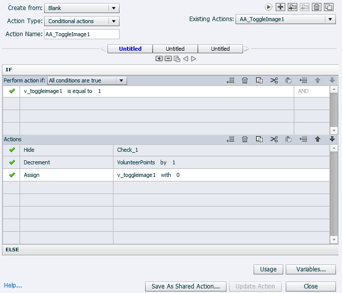

I'm not sure how to setup my advanced actions for my slide.

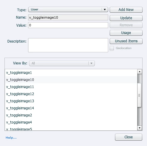

I’ve got 14 buttons for a 14-question self-assessment. The Self-assessment is self-scoring, so 9 out of the 14 questions have a scoring value (1) added, the other 5 do not have a scoring value (wrong answer). Each question has its own variable and advanced action. I tried to follow a way to do this via an eBook that I think was written for Cap7, so I didn't use the actual "toggle" action. Can someone help me update my advanced action for Cap 9?

    This looks too much complicated. Did you define all those variables with a default value of 0? Which default value did you give them? Do you need to report the score? Is my understanding correct of what you want to do?
    • You have 14 interactive objects (buttons), 9 have a score of 1point, 5 have no score: did you attach that score in the Reporting section? If yes, why do you still track the score with a user variable (Volunteerpoints), since it is already tracked by the system variable cpQuizInfoPointsscored?
    • You are in Captivate 9: why do you use a checkmark with hide/show instead of adding a state to the 'button'?
    If you don't need to report, and want to have the score in the user variable v_points (sorry I'll use that shorter word for your Volunteerpoints), and user can 'un'click a button which will need decrementing the score, but not for a 'wrong' button. This means you'll need 2 different conditional actions, one for the correct buttons, and one for the wrong buttons. I would use a shared action in this case.
    A. For wrong buttons:
    IF v_one is equal to 0
        Toggle v_one      v_one will be the first parameter
        Show check1            check1 will be second parameter
    ELSE
        Toggle v_one      v_one  is already defined as first parameter
        Hide check1        check1 is already defined as second parameter
    B. For correct buttons
    IF v_two is equal to 0
        Toggle v_two      v_one will be the first parameter
        Increment v_score by 1        no need to define v_score as parameter
    ELSE
        Toggle v_one
        Hide check1
        Decrement v_score by 1
