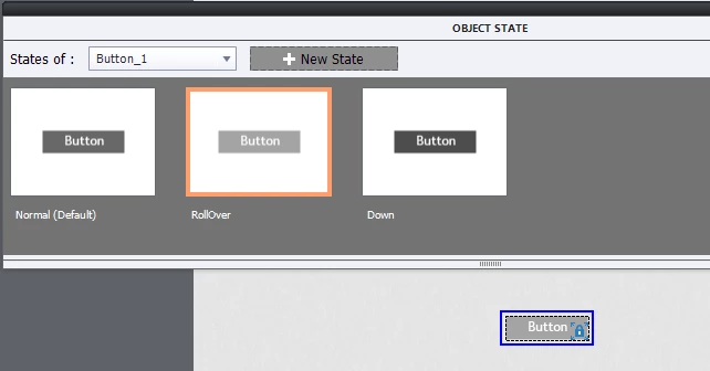

    Hey Lilybiri
    Here is my OSM, my State view and my Version
    In the State editor, you can see that the Normal and Down States are fine, but the over is a problem. BTW this is happening on other machines in use by friends that I just checked with
    KB in FLAuthor
    March 2, 2016
    More info
    We get the same type of issue if we create a custom style
