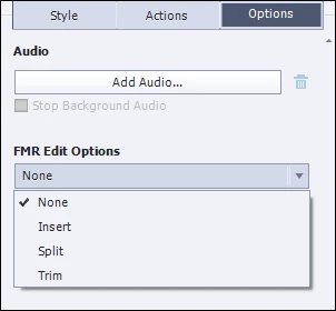

Lilybiri
July 28, 2015
OK. In that cptx-project are you talking about FMR slides? They are still recognizable at a camera icon in the Filmstrip, and a red line in the center of the slide timeline in the Timeline panel. The edit options are under the tab Options:
Personally I try to avoid FMR-slides, and replace them by CPVC slides because the quality is much better and those cpvc (Video Demo) videos have a dedicated Video editor with a lot more options than the simple old FMR-slides. It is more work, you have to stop the software simulation capture, to create the video demo slide, it is not automatic.
