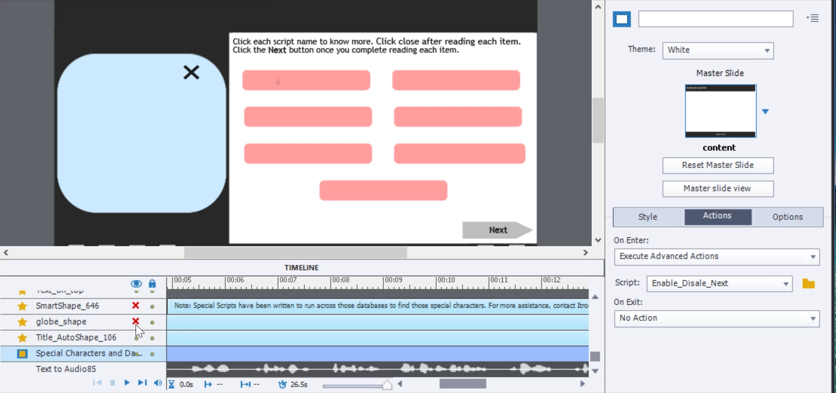

So, I tried to create a slide where the Navigation for next(nextbutton_187) would be disabled upon entering, and I created a Next button (Next_button_2) on the slide, which would be enabled at the end of the slide.
Below is the screenshot of the action chosen for Slide 43. for each pink button, I have created variables named as button_1, button_2 and so on.

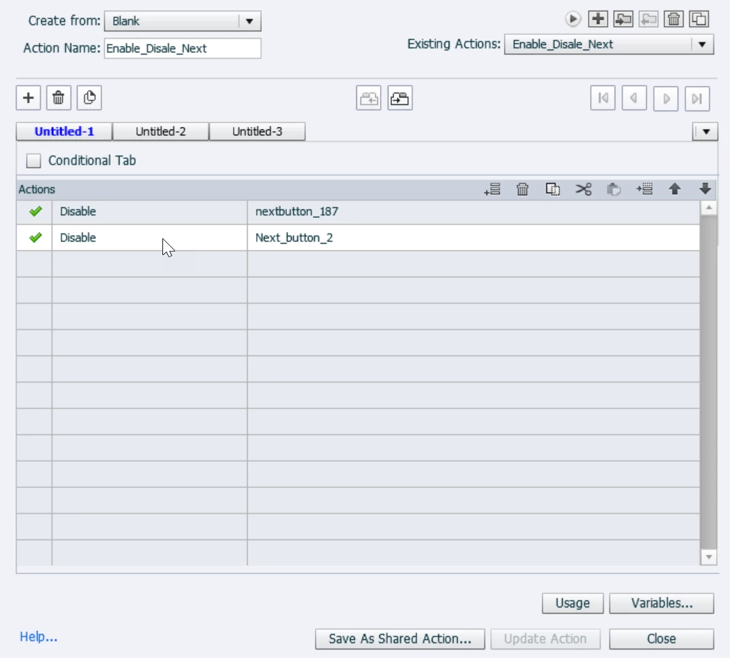

I am providing a screenshot for the script where I specified that the buttons would be disabled upon entering.

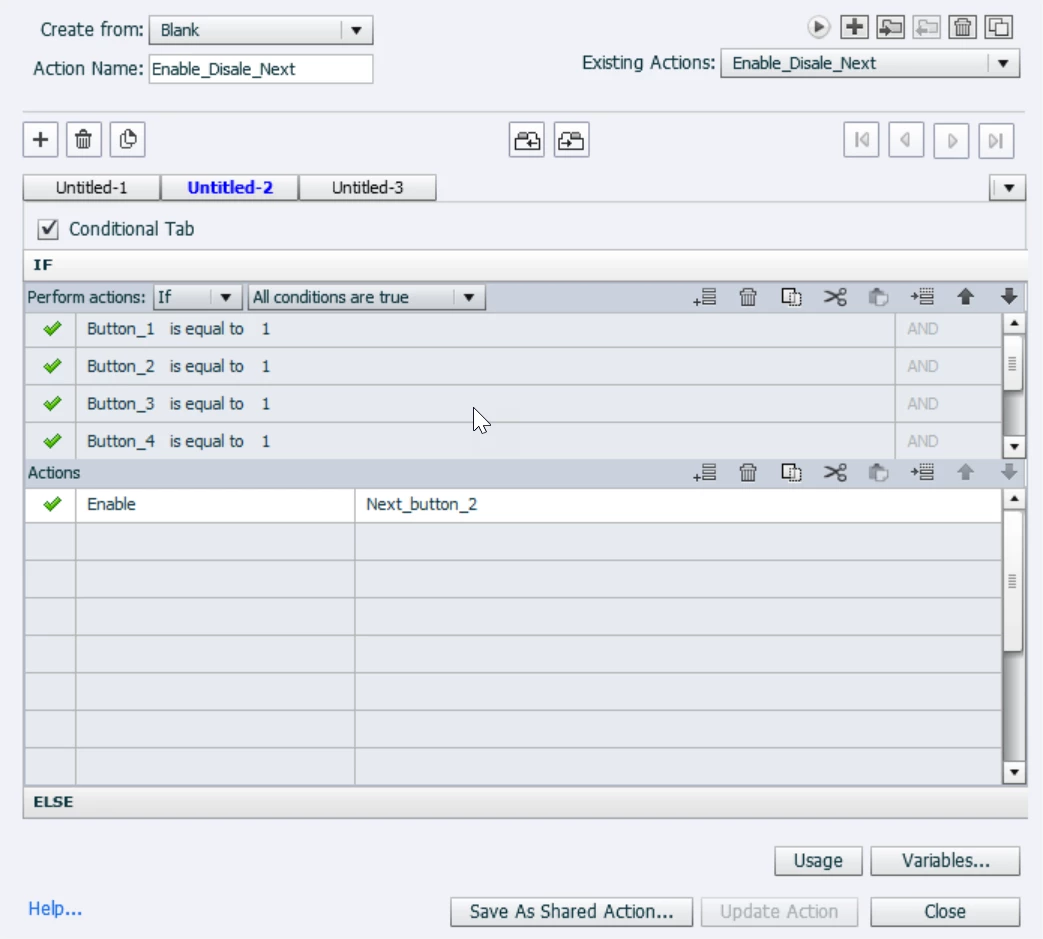

On the same script, I have created the condition that all of the pink buttons needs to be clicked to enable the Next_button_2, shown in the below screenshot.

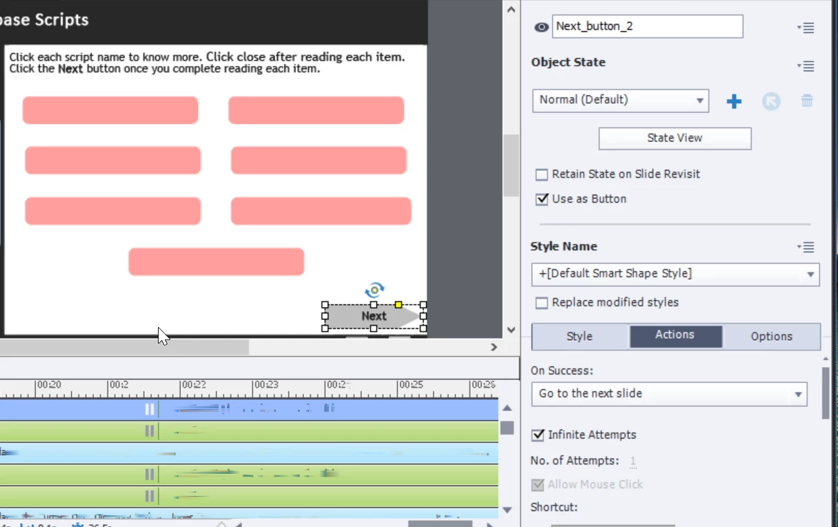

In the below screenshot you can see that the Next_button_2 has been given the action of Going to the next slide.

    You're currently triggering this Conditional action using the On Slide Enter event.  However, that event only fires when you are entering the slide, not after that.  From your description of the interaction, the user is expected to click all of these pink buttons while remaining ON that same slide, correct?  That means the conditional action that is supposed to enable the Next button only gets executed once when entering the slide but not again.
    The better way to set this up is to have the Conditional Action get executed whenever one of the pink buttons gets clicked.  This means that your pink buttons will need to be executing an Advanced Action, not just a single or simple action that does just one thing.  So the Advanced Action of each pink button will need to first execute whatever actions they were supposed to perform (e.g. Hide or Show other objects) then also set the value of the tracking variable which records the fact that this button was clicked, and then finally perform the Conditional check to see if all of the tracking variables have now been set to 1 so that the Next button finally gets enabled.

    In your example screenshots shown above, the first section was non-conditional but the second one was a Conditional Action, because it would only execute the actions if all of the variables were set to 1.

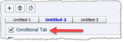

    Then in another section of the same Advanced Action, you would need to select the Checkbox for Conditional Tab (as you had in your own example for the second section).
    This is where you need to add your condition that checks all variables to see if they are now set to 1 and if so, then execute the action to enable the Next button.  (I would have chosen to improve this slide a little more by initially hiding the Next button using the Conditional Action to first Show it then Enable it.)
