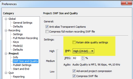

    Default quality for slides in CP4 is Low 8-bit, which allows for only 256 colors and you'll have issues with transparency mostly. You can change that quality for those slides that need it (with quality images) in the slide properties. Mostly I'll change to High or Optimized. This will result in bigger file size of course:
    What is possible as well is to override the slide quality on publishing by changing the Preferences, this will result in having all slides the same quality (here 24-bit) and of course the file size will increase as well, and more than when you choose to setup the high quality only for selected slides that need it.

    PS if it is still not sufficient, turn off the compression options...

    must be a problem with the quality settins, you can change them on slide level and on project level.
