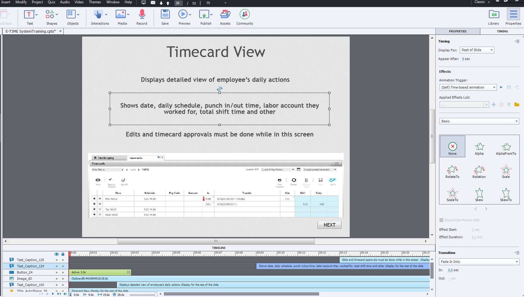

This is a slide I am having difficulty with. The second and third caption boxes do not show up where I have it timed when I go to publish it. The timing properties box for the second caption box is shown.

There is only part of the timeline visible, both horizontally and vertically. But luckily I see already one cause of the problems
You have inserted an interactive object (green timeline) Button_...  which is pausing the slide at the end of its timeline. That is a pausing point and everything scheduled to come in later will not appear in Preview or after publishing. What is the goal of that button? Maybe the interactive movie in this blog post could help explaining:

Tell me what that button is supposed to do, and why it is scheduled to disappear quickly. Maybe you have even more interactive objects on that timeline, but that is the only one visible in the part that you showed me.
