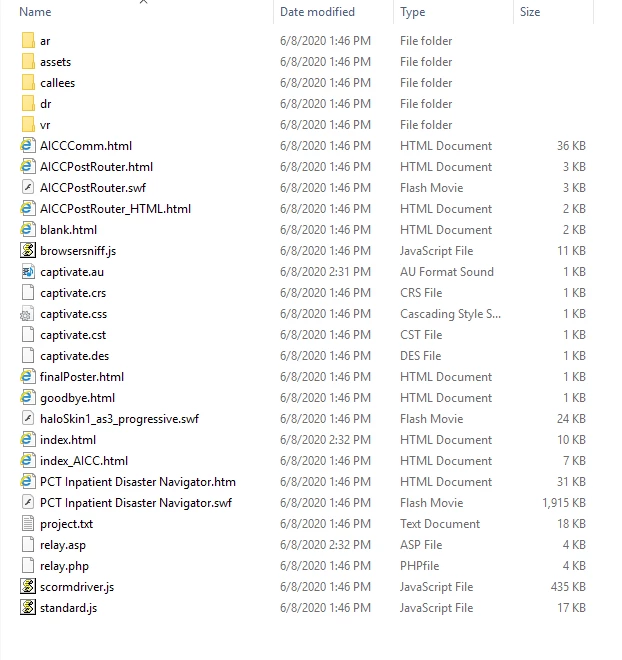

We WANT to be able to tweak the already exported files so that they route directly to the HTML5 version of the files published in the same directory WITHOUT having to re-export all of these 200+ individual courses.
I'm familair with HTML and some basic javascript but when I try to follow what's going on with these files from the index.html file I get lost.
Thoughts? Suggestions? I've included a screen shot of the output files from one of our projects.

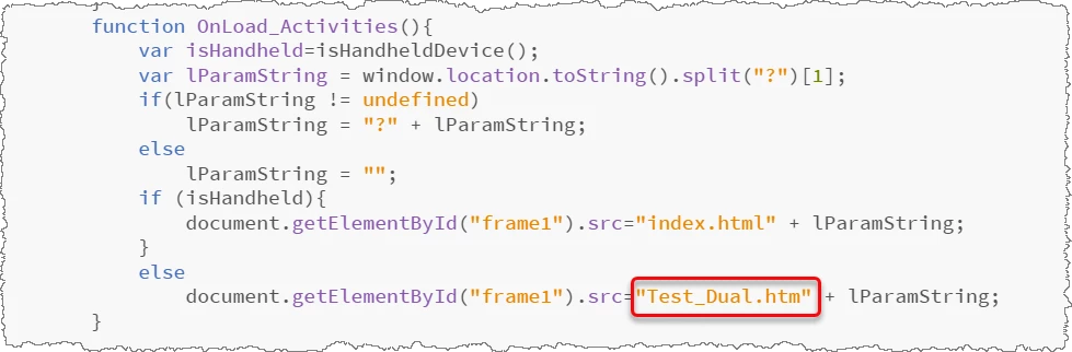

Regarding your current question: With Captivate's dual output publishing option, the multiscreen.html file is the one that decides where to redirect the user, based on whether or not they are using a mobile device.  Unfortunately this 'sniffer' script will send everyone NOT on a mobile device to the SWF version of the content.  If you wanted to avoid republishing and just modify one of the files so that everyone gets the HTML5 content then that's the file I would suggest you look at.  Somewhere inside all of that code you will find these lines:
As you can see, my CPTX project was called Test_Dual and that's why the .htm file has that name.  If you look for this code where it uses the name of your project in the multiscreen file then you should just be able to change the code at this spot to point to the index.html file instead so that regardless of whether the user is on a mobile or non-mobile (i.e. desktop or laptop) then everyone gets the HTML5 output.
Give that a try.

The answer your'e presenting was the solution I initially found. Sadly, it doens't quite apply to us. Our output files DO NOT contain a multiscreen.html file. If you look at the attached image in my post above you'll see that file is not present there, nor in any of the sub folders.
I BELIEVE this may be because we are forced to publish in AICC format. That's not something we can change at the moment so we have to stick with that.
You hit the nail on the head though as far as solutions. How do we find where the AICC equivelent of that is happening?
