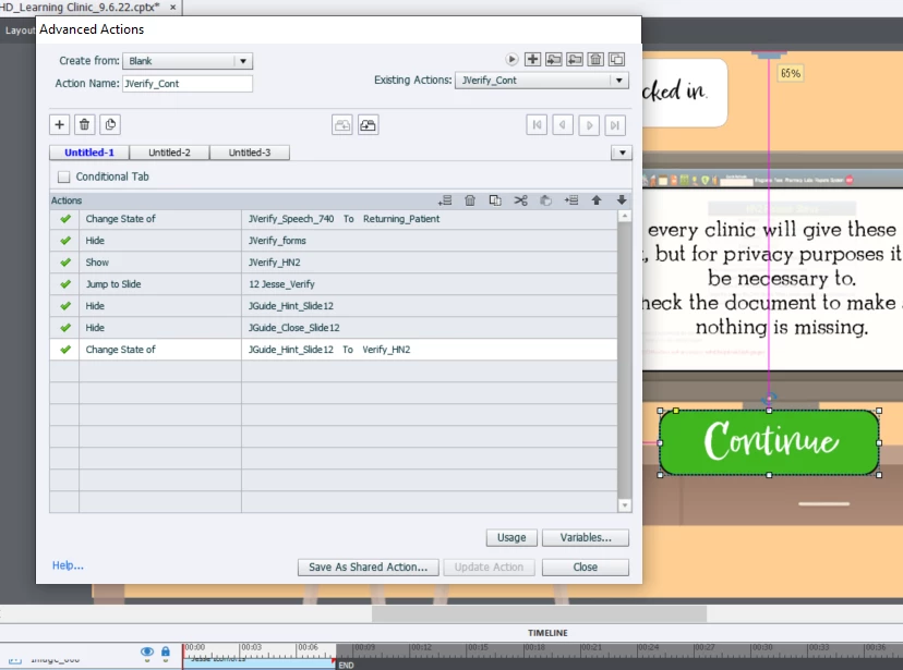

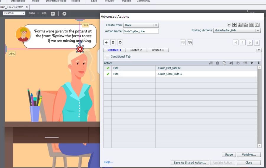

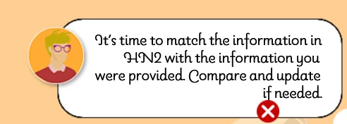

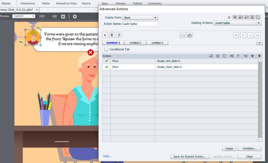

    @Lilybiri- I've attached images of the Advanced Actions I used for this. The text is the Multi State object. When a user completes a task, the button they click changes the text to the updated hint. This action is ocurring accurately, there is just the text of that item appearing on the screen before a user even clicks the helper button. I hope I am explaining this well enough.

    It is getting a bit clarified now. I thought you used shared actions (in your original question)?
    You are mixing Show/Hide actions with state changes. For the multistate objects you do not need any Reset action if you leave the option 'Retain State when...' unchecked. However for the objects addressed with Show/Hide you need to check the status On Enter and execute the opposite action. I suspect you could have more multistate objects to avoid that. You never see the Close button when returning to the slide?  You didn't group it with the Hint - which I should have done -  in Show and Hide actions. That would have simplified those actions to one Show Group and Hide Group action and spared one command line in the first advanced action. You could use it also On Enter for the slide, just Hide Group. There is however one other object which is made visible in the longer advanced action, which may need hiding On Enter as well.
    Which object do you wrongly see when returning to the slide?
