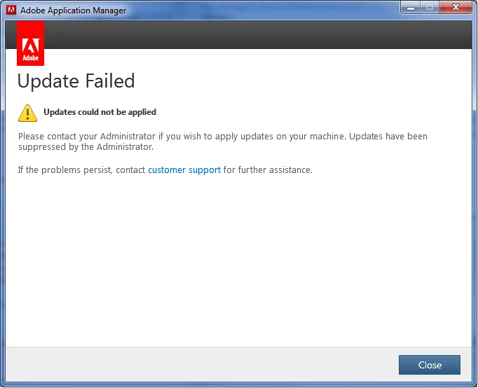

We were unable to install the patch update from inside Cp7 because the Help > Update button was greyed out (disabled) for both myself as a user, as well as the IT person, even when logged in with full Administrator privileges.  So they downloaded the update patch file from the Adobe website and tried to install the patch from outside Captivate by launching the update EXE from my hard drive.  Still no luck.  The message that appears says that the update has been blocked and they should contact their Administrator.  There's the rub.  They ARE the Administrators!

    Hi Rod,
    I want you try one more step on your computer .
    Please close Adobe Captivate then go to C:\Program Files (x86)\Common Files\Adobe\AAMUpdaterInventory\1.0
    There will be a .dat file by the  name - AdobeUpdaterAdminPrefs.dat
    Change the value in <Suppressed> tag to ”0”
    <Preferences>
    <Suppressed>0</Suppressed>
    </Preferences>
      After saving the bat file close the window and then try to install the update again.
    Hope this will fix your issue .
    Thanks

    Here is the error message for what it's worth.
    The person seeing this IS the Administrator.
