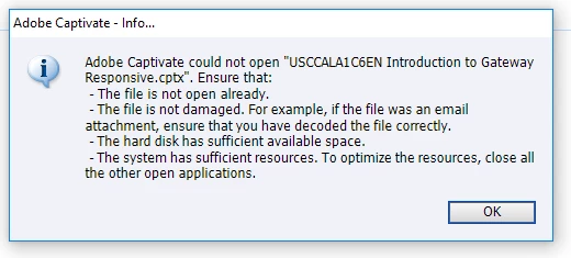

When I try to open a file that is already created it gives me this message:

    Erik Lord
    July 25, 2017
    Did you investigate any of the issues the dialog suggests?
    If all those are ok, especially HD space and resources, do you have the file backed-up anywhere?
    CP files do get corrupted on occasion, the chances are apparently higher if you're opening a project from a network location. Its generally recommended you work locally (open/save the project on your local machine) and save up to a network drive or other backup location daily.
    Otherwise this may help:
    How to recover a corrupted Adobe Captivate project
    sarag66716594
    July 25, 2017
    Yes, I did look into those but don't think any of them are the problem. The file is something that was created a couple years ago by someone else and I am trying to go back in to make some edits to things that have changed in the past couple of years. Any ideas?
