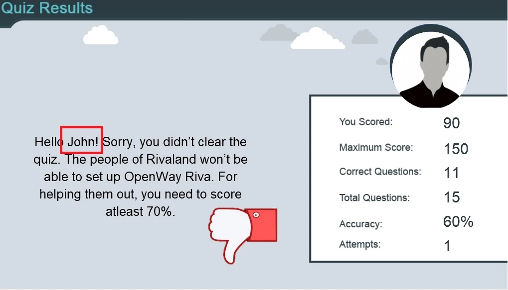

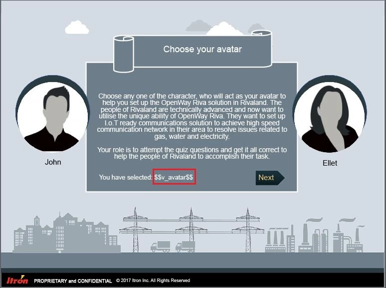

There is a variable: v_avatar and there are two characters. The characters name are: John and Ellet. If the user selects John, v_avatar will store the value John and if the user selects Ellet, v_avatar will store the value Ellet.
I have used the $$v_avatar$$ to display the stored value. In the below image, I have highlighted with red color.

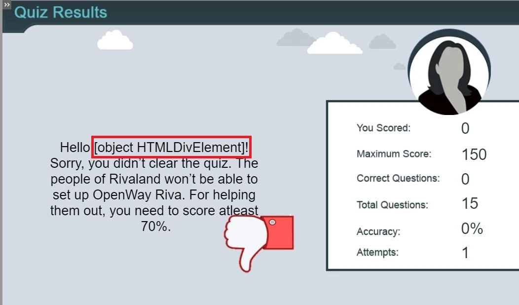

When I preview the slides I am getting the variable value displayed as selected (John for John image selected and Ellet for Ellet image selected) but when I am publishing the same project as HTML/SWF output, it is displaying: objectHTMLDivElement which is the HTML object. Please find the result slide image below:
Kindly help me with this as I don't know how to get the variable value displayed at run time when I am publishing as HTML/SWF.

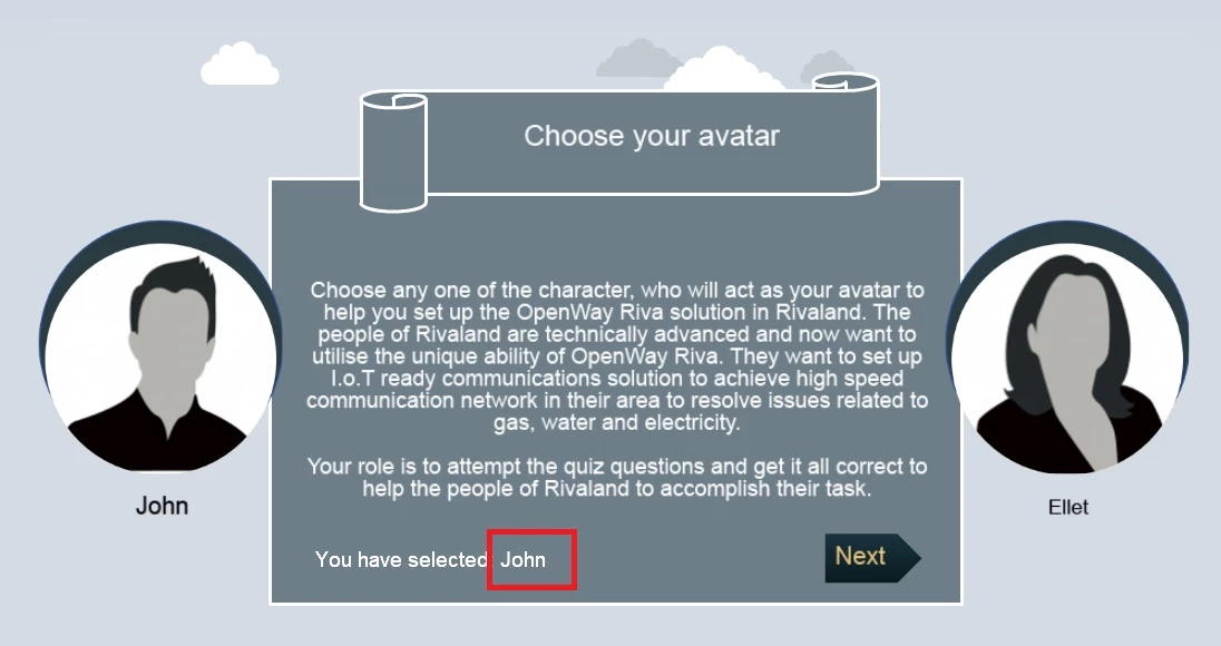

    October 11, 2017
    Yes I see the value when doing preview (pressing F12). The highlighted area gives me the value of the selected avatar. Please find the screenshots of both the instances where the variable v_avatar shows the value John as I select John. But this value doesn't appear when I publish it as HTML/SWF.
    When pressing F11 or previewing in HTML5 browser I am unable to see the value.
