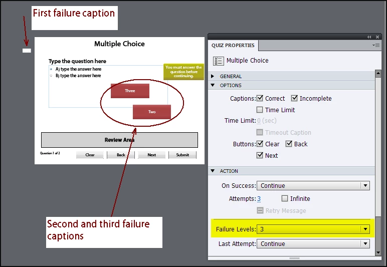

    There are up to 3 Failure levels possible for question slides. Each failure level will add a Failure caption, that you can fill in as wanted. And if you don't want the first one, do not delete it (because otherwise the failure levels will be decremented) but drag it off the stage.
