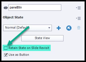

    StagPrime already pointed out what you need to do to keep the custom state when leaving the slide.

    Oct 20, 2020 5:29 PM UTC
    Have you checked this box for each of your buttons?
