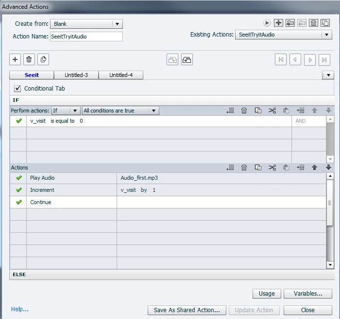

    June 25, 2018
    Although your instructions are not very clear, and your blog reviews the buttons well, but does not provide any insights to the processes behind the commands, I was able to guess my way through the process using the information you provided in your response above so thank you.
    In an effort to be helpful to other readers I'm adding the screen shot of the changes I made to my previous screen shots shown above.  The addition of "Increment" corrected the issue and my Audio_second played upon revisit to the DecisionSlide.

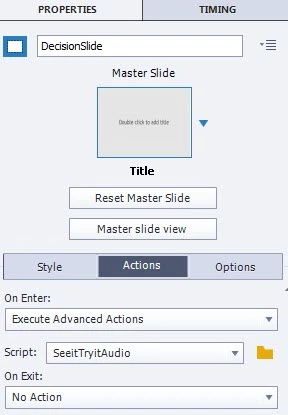

    June 22, 2018
    You don't tell what has to happen iif it is possible the learner comes back a third time to that slide? I'll suppose that is not possible and that there are only two audio clips needed. Will label the audio clips Audio_first and Audio_second.
    If you don't need CC, do not use slide audio. It is much easier to use the Play Audio Command, or eventually Object audio.
    Create a user varaible v_visit, with a default value of 0.
    Create an advanced action (no creenshots, don't know which versio you are using):
    IF v_vist is equal to 0
      Play Audio_first
        Increment v_visit     or Assign v_visit with 1 will do the same
      Continue
    ELSE
       Play Audio_second
      Continue
    Assign this action to the On Enter event of the slide.

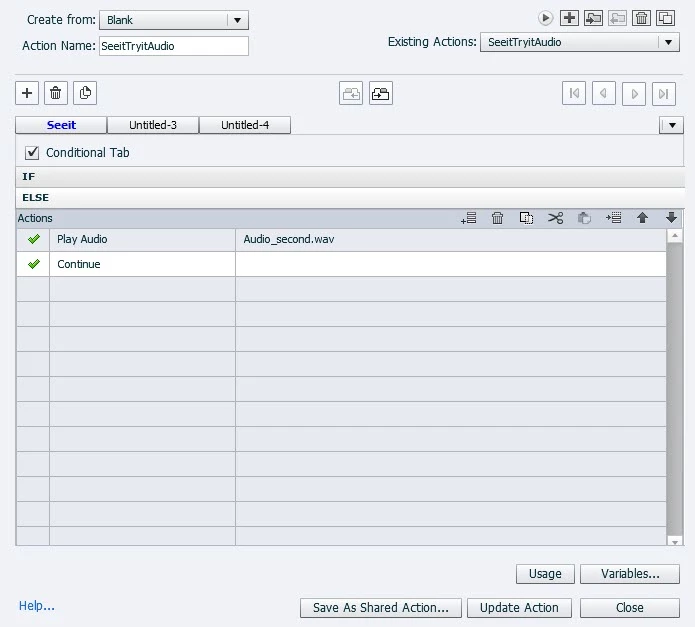

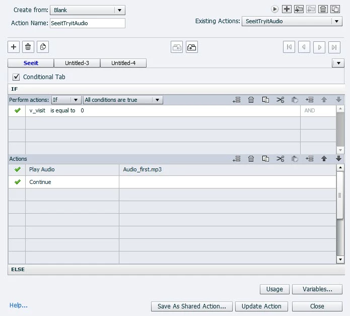

    I set this up as I understood you to explain above, but my second audio still did not play, the first audio played initially and again upon return to the decision slide, audio_second never played.  Here are my advanced actions:
    and here is the action on my slide:
    What am I missing?  Should I have done something with the variable?  This is my first time using Advanced Actions and variables in Captivate.

    June 25, 2018
    You never change the variable, which should be done in the THEN part, ELSE part remains as you have it:
    IF v_visit is equal to 0
         Increment v_visit
         Play audiofirst
         Continue
    Please check my blog post about the Advanced Actions Dialog box in 2017.
