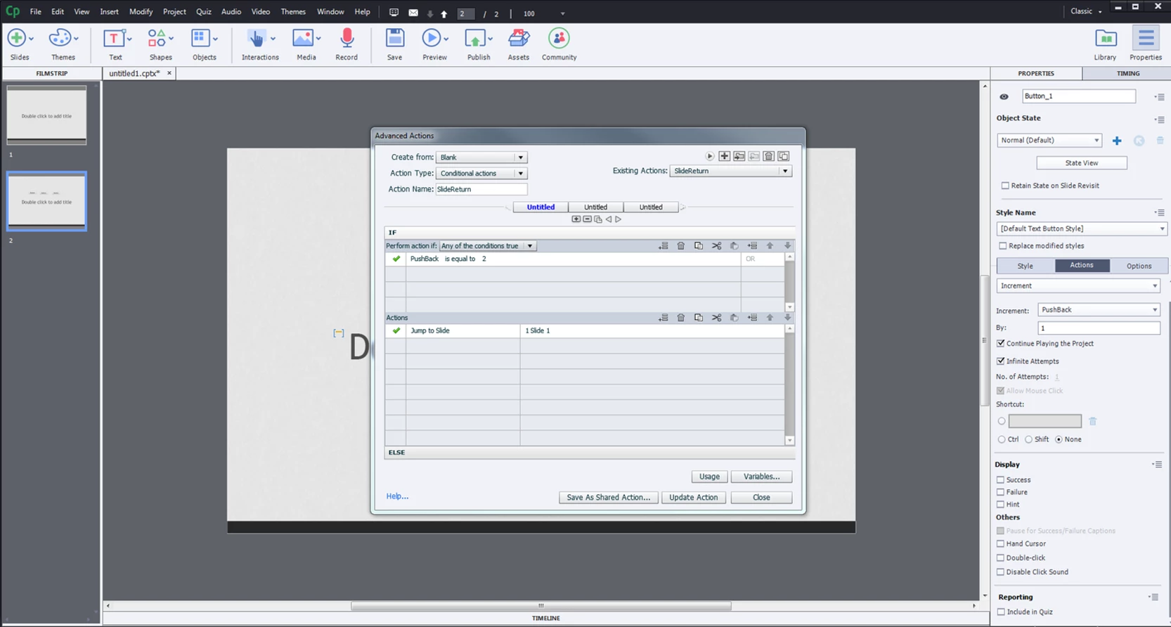

    Built it and it ran perfectly using the above logic:
    Capture
