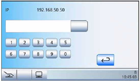

Hi Lieve,
I think I have solved my problem by making it less complicated.  Instead of text entry boxes, I am using simple text captions which contain the variable that a user can manipulate with the keypad.  See the image attached.  The user will be able to use the number pad to enter a new IP address, and when he is finished he will press the submit button (arrow).  Upon submitting, what the user entered will be checked against the IP address he should have entered and will be given the appropriate feedback.
Originally, I had text entry boxes (one for each 'octet' of the IP address) and the number pad was not interactive.  The user just had to use the numbers on his keyboard to enter each octet, and could toggle between the octets with the button at the end of the text entry line.
With this new solution, the user cannot use his keyboard  -- the text entry boxes are gone -- and he has to use the number pad, which, in this case, is more realistic.
