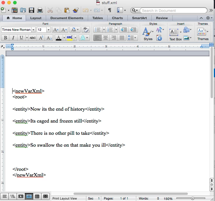

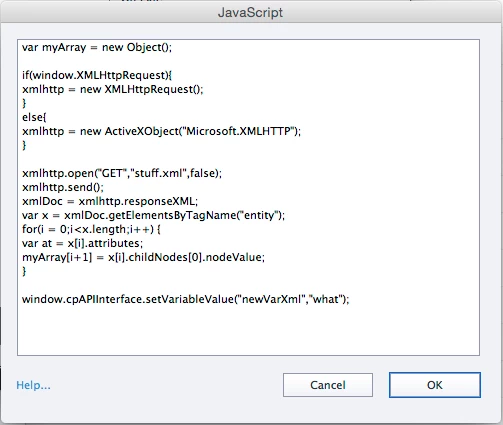

November 11, 2015
I've tried the the following js/xml code with no luck.  Has anyone got it functioning.  I have it on hosted on a google drive. It is not getting the xml data to the array.
TLCMediaDesign
November 12, 2015
You are setting the value of newVarXml with "what" which is not a variable and if it is you would remove the quotes. what is also not defined in the code anywhere.
Also, when populating the array myArray in the loop, you are skipping the first index so you myArray[0] would not hold any value.
I've also found that Captivate does not like loops in the script window.
November 12, 2015
"what" is the string that populates the newVarXml and will display on the screen so that line is working. You are correct that [0] is empty so the array should populate starting at[1]. The script runs and will show "what" from this line: window.cpAPIInterface.setVariableValue("newVarXml","what"); but when I try to populate the newVarXml variable from this line:  window.cpAPIInterface.setVariableValue("newVarXml", window.myArray[1]);  which is on another page it will go blank which tells me the is no information in the variable. So the XML data is not populating any of the array locations.  It should populate myArray[1] - [4].
On the other hand if it doesn't like the script window I guess I could insert it into the published file directly and see how that goes. The code was taken from the video referenced at the top of the page.
