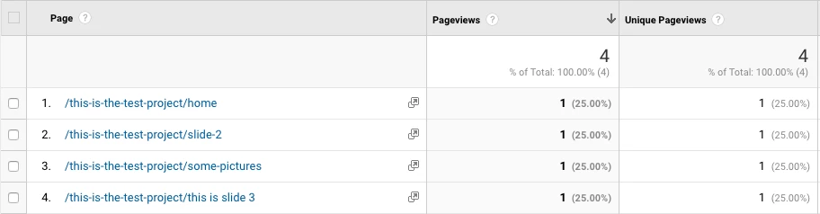

Working! Adding GA to On Enter event
The following code is added as Execute Javascript action (current window)
//start code

Bingo! (GA report below)
