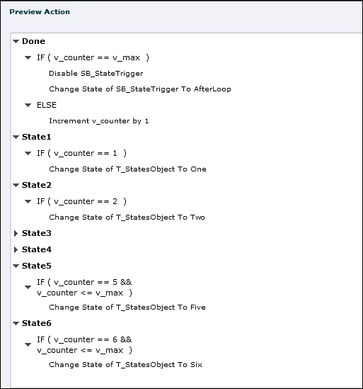

Here is a script example:
This was set up for 6 states (for a text container, the Normal state was an empty shape).
There are 2 user variables:
  • v_counter has a default value of 0
  • v_max is the number of states, you can replace it by the literal '6' or what you need
The first decision "Done" checks if the counter has reached the maximum value (v_max). If that is the case all states have been shown and it should end the loop. That is why that decision will disable the button used to change states (SB_StateTrigger) and here also change its state to an invisible state (AfterLoop). When returning to the slide, the state will again be Normal (visible), and you only have to enable the button again. You can replace this by a single Hide action as well if you want.
If the first decision is not true, there are still states to be shown and the counter is incremented.
The other 6 decisions are all similar (I collapsed 2 of them): they will test the value of the counter and show the associated state. From state3 on I used a combinated criterion. That makes it possible to use exactly the same advanced action also if the total number of states is lower than 6. You only have to change the value of v_max.

??? How would you do that, Rod? OP wants only to use the simple action 'Go to Next State' triggered by that button. Indeed, it will loop through the states, and once you reach the last state, it will restart from the first state.
It would be a nice feature to add, but don't know if it is possible. My 'cheating' is to add a blank state as last state, and hope that the user will not continue to click the button.
Other approach is of course not to use the simple action, but a conditional action. Since there is no looping possible, and the action 'Go to Next State' is not available in the Advanced Actions dialog box, it will be more complicated because you'll have to use a counter and a decision for each state. It is then possible to disable or hide the Next button within the last decision. I understand that this seems to be rather complicated for what is thought to be a simple looping.
