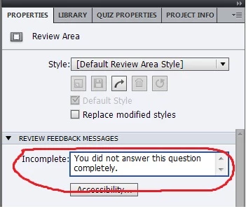

  • On your Quiz Slide at the bottom there will be a Review Area.
  • Double click on the Review Area to see the Review Area Properties.
  • Under properties on the right hand pane you will have a section named Review Feedback Messages. See the Picture below:
  • Here delete the text inside the "Incomplete" box.
  • Now test your project with the quizzes. Make sure the number of attempts are more than one.
This should solve the purpose for you.
