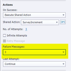

Hi! I'm trying to use remediation then feedback for incorrect answers with a multiple choice question slide.
The process looks like this:
1. Answer multiple choice question
2. If incorrect, receive incorrect feedback message stating the learner will be redirected to the content and have another try
3. Click anywhere to jump to slide with remedial content
4. Click "return to quiz" button and it jumps back to the question slide
5. Submit answer a second time
6. If incorrect, receive level 2 incorrect feedback (to provide a hint as to the correct answer)
7. (No remediation)
8. Allow user to submit answer again
9. If incorrect, advance to next slide (would like to have a different feedback message here too)
10. Allow unlimited retakes for the quiz, in case three tries per question isn't enough (quizzes must be passed with a 100%)
I am setting "advanced actions" for each answer option to set up the feedback (#2) and remediation (#3-4). However, I don't know how to add the feedback message that changes for the second attempt (#6). If possible, it would be nice to be able to change it after a third attempt too (#9).
Lilybiri
February 14, 2017
You can have multiple failure messages:
I cannot answer the other questions, because I don't know how your advanced actions are set up.
