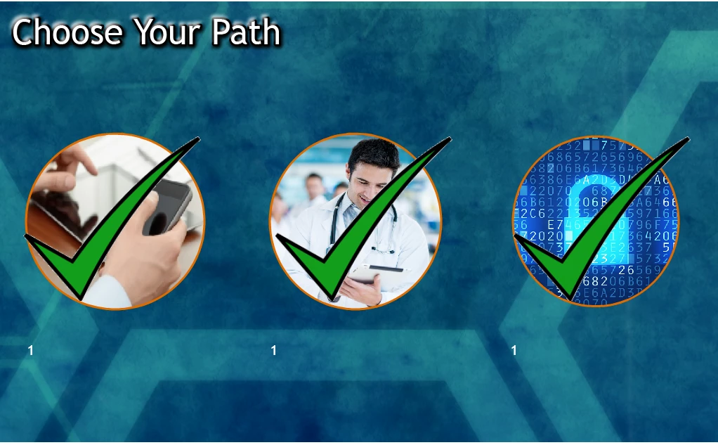

Hello, i am using variables to make a condition.
A user will navigate through three lessons. Each time they finish a lesson. I have three variables that incriment by one each.
The condition I made in the advance action is that is all three variables are equal or greater to one, then a button will show.
The variables count up to one a piece, but the button never shows. Does anyone know what I'm doing wrong?
I've allowed the variables to show to test it. The button should be at the bottom, but nothing. Can someone help?

    That is not a normal behavior at all. But on your screenshot I see that the button is 'inactive'. Can you check its Timing Properties: where is the pausing point set, it looks like it is very close to the start of the slide. The screenshot is too small to see exactly the pause. Even when the button is set to Invisible, there should be an active region.
    To execute the On Enter action you have to 're'-enter the slide indeed.  As I told before, you don't really need that action, you can trigger it from the button that jumps from the menu slide if you have two decisions in that (conditional) action. But you have to move the pausing point, it has no sense to pause at the first frame.

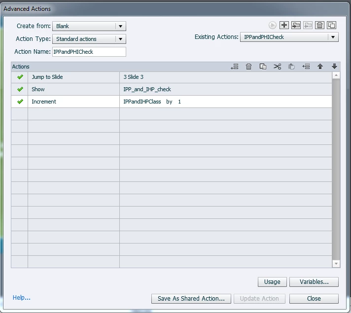

    1. Always = mimicked standard action
      IF 1 is equal to 1
          Jump to ....
          Increment var
          Show checkmark

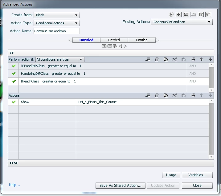

    2. CheckVars
      IF var1 is equal or greater than 1 AND
          var2 is equal or greater than 1  AND
            Show Next button

    The issue here is that I suspect the advanced actions are created but not applied to an event.  Both actions could be combined in one conditional advanced action triggered by the 'Jump' button: first decision being a mimicked standard action, the second decision the condition itself (sequence important). Since the Jump command is the first, the user will not be aware of the Next button appearing after the last variable has been incremented.  Or the standard action can be triggered by the Jump button and the conditional action by the On Enter event.

    It is not a screenshot of the slide that is needed, but of the advanced action. Also explain which events are triggering which action?
    This use case has been treated so many times on this forum and in blogs. It is pretty simple, but can be set up in many ways.
    December 2, 2015
    Here is an example of one of the advanced actions that leads up to the condition. Its the same for all 3, the only difference is in the show section, where there is a name for each completion of a class.
    The second screenshot is the conditional action. All variables start at  zero.
    If all three get incremented by 1, the condition here is to show a button named "Let's Finish this course" As you can see from my project pic, all three variables have a 1. Why is the button not showing?
    Lilybiri
    December 2, 2015
    Repeat my question: " which events are triggering which action?"
