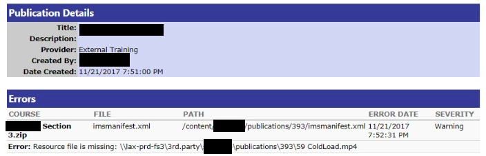

I published a file to SCORM 2004 3rd edition in both SWF and HTML for a customer. This file has an mp4 video inserted as a progressive download video type. The customer was receiving an error when uploading the published zip folder to their LMS - specifically calling out the imsmanifest and the video file. I blacked out any information regarding the customer, but this is the error they received in Cornerstone:
I opened up the zip folder I sent the customer. The video file was placed into a folder called vr, so it did exist as an asset. I then took a peek in the imsmanifest to check the links to the video. There were two references to the video file:
--one that points to the video being in the root folder (which it wasn't)
--and one that correctly points to the video being inside the vr folder
I corrected the folder location for the first link in the imsmanifest, packaged it back up, sent it to the customer, and everything uploaded perfectly.

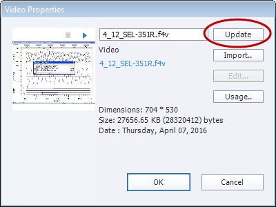

I then updated the video file in the library before republishing, and this time the video was placed inside both the root folder and the vr folder - the imsmanifest was then correct.
So what exactly does 'updated the video file in the library' mean? That seems to have been the step that resolved the problem.

To update the video file, you click on it in the library and hit update - then browse to the same video file. It refreshes the cached copy inside the library.
