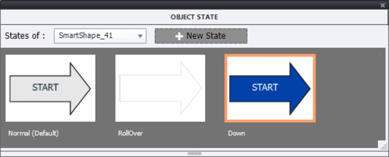

Button
When I hover on top of a button it disappears.
Am I doing anything wrong?

The Rollover state should appear, it is probably blank (not normal at all). Check by opening the Object State panel with the State View button in the Properties panel of the button.

Excuse my ignoorance, but what exactly do you mean with the below? It is marked on the normal state currently. Whilst in the edit mode, the button appears fine but when in preview mode it disappears when I hover upon it.

Especially if you want to use Quick Start Project slides (like Safety) and also for your question about the button, you need to learn how to use Multi-state objects. For the button, try what I already mentioned in my first answer:
  • Select the button and click State View in the Properties panel. That will open the Object State panel.
  • Unless the button has been edited you will see 3 states: Normal, Rollover and Down. I created for this screenshot a button where the Rollover state is 'invisible', which would clarify why the button seems to disappear on hovering over it:
