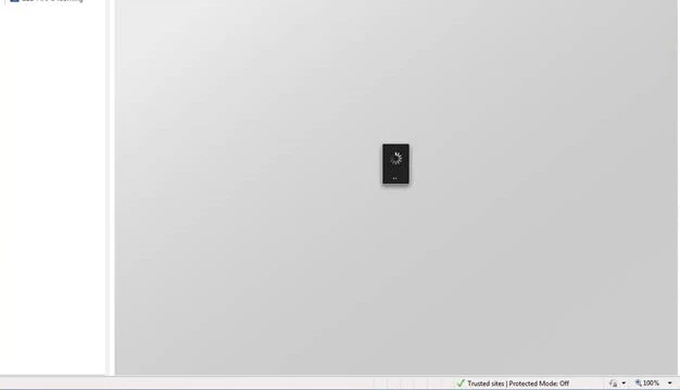

Good day all,
Has anyone had a situation where there is a very long load up time. I am playing content through a LMS and it either does not load or just continually tries to load forever. I wonder if there are any settings within Captivate that would cause this?

And how many megabytes is your published content?  You haven't stated that, but this is usually the biggest factor.  Also check whether or not your preloader is set to 100% as this is the default setting in Captivate but can be reduced significantly to improve load time performance.

Great! we changed to 25%.
