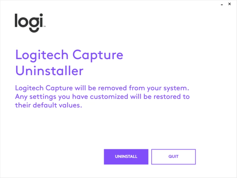

Feb 11, 2019 12:39 AM UTC
Hi, we had the same problem recently and it came down to a Logitech program that recently installed itself, called Logitech Capture.
We uninstalled Logitech Capture, and Captivate Video Demo worked perfectly after Logitech Capture was uninstalled.
Seems to be a clash.
Hope this helps.
Lilybiri
Feb 11, 2019 10:09 AM UTC
Thanks for posting this possible cause!
boatguypat
May 4, 2019 7:20 PM UTC
I too am having issues with my Logitech Brio webcam when trying to launch Video Demo. Uninstalling the Logitech Capture software did resolve the immediate crash when launching Video Demo. Now, i can open Video Demo and select the built-in web cam, but when i switch to the Brio webcam, Captivate 2019 (latest version, run as Administrator, all local drive locations) crashes. I have also removed the Logitech camera settings app and Personify Chromacam. Oddly enough, when ChromaCam was installed, Captivate did allow me to select this as a web cam and create a Video Demo. (ChromaCam essentially impersonates the Brio web cam, or whatever web cam you select in the ChromaCam settings). My Brio also has the latest firmware and Windows 10 driver.
