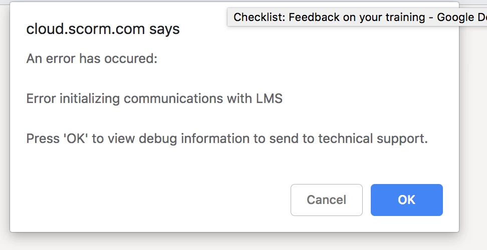

I tried to publish it to SCORM cloud and it asks me to allow pop-up from the screenshots below:
Then this pops up. When I click "OK", it loads for a few seconds.
Lastly, this happens and then the course starts.
Not sure what to think here.

You should be able to set the preferences in SCORM Cloud to load the content in the same window, which would then mean there was no popup to be allowed.  But that's not the issue the error message is talking about.
That error is normally due to the LMS not being able to communicate with the SCORM module.
Did you set this module up properly as a SCORM zip with Quiz Reporting turned on and set to something like SCORM 1.2 or 2004?
