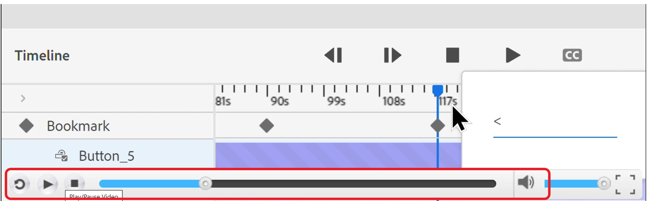

Jan 25, 2024 2:04 PM UTC
There is no official name 'CP2021' but from the description I suspect you mean one of the later versions of CP2019. You find the exact version numer under Help, About Captivate.
The Captivate playbar always is for the complete project. No way to edit it. Out of the box, there is no way to show a slide playbar.
I suspect you inserted the video demos as slide video or created them from within the project which also lead to slide video. Those are synchronized with Captivate's Timeline.
Not sure to understand exactly what you want. Did you ever try to use event videos instead of slide videos? Event videos are not synchronized and get an individual control panel when you hover over its bottom. When the video plays, a scrub bar will appear which is limited to the video:
I indicated that control panel above with the  red rectangle. You see the progress bar, and it is possible to move the round button to scrub forward or backwards.
