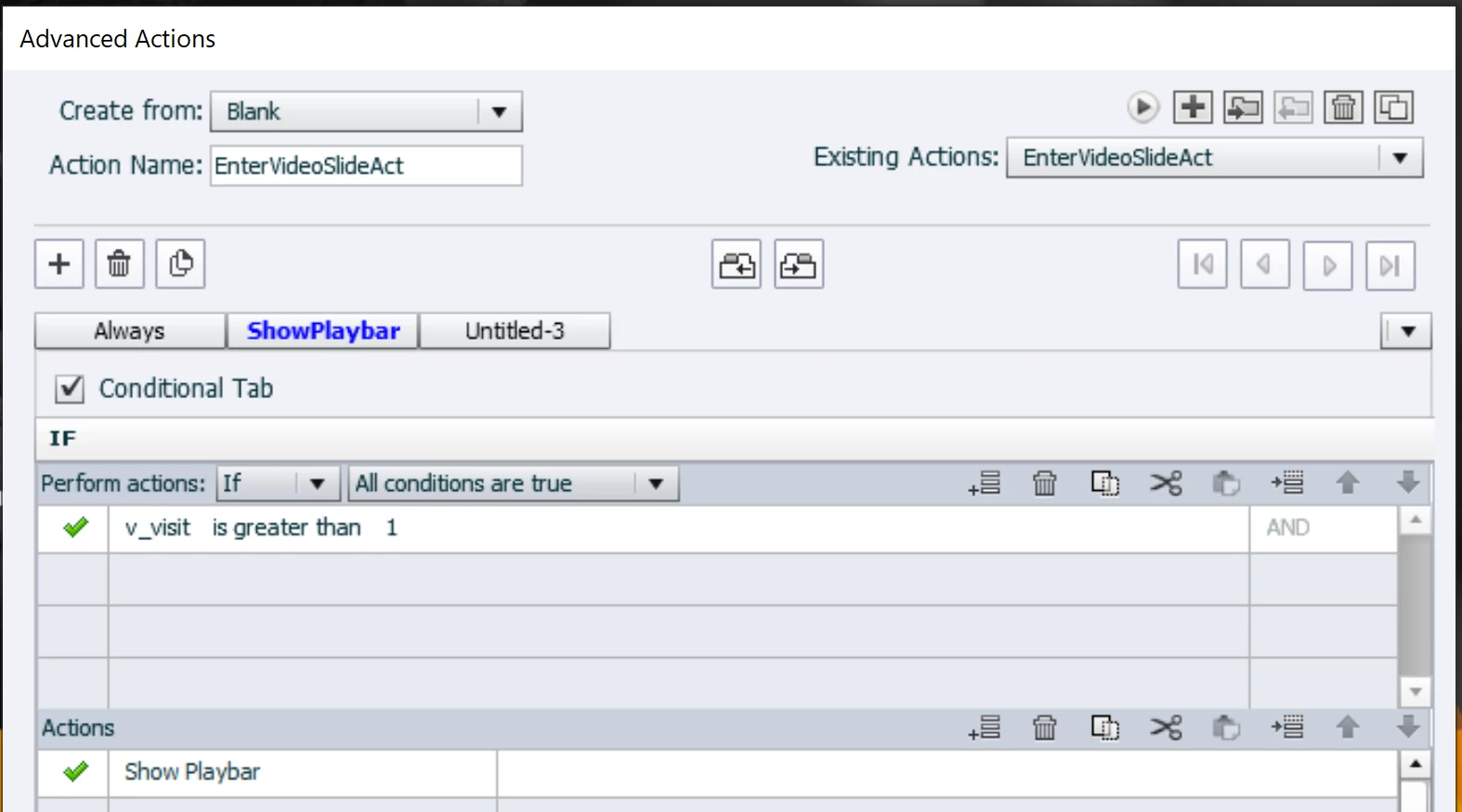

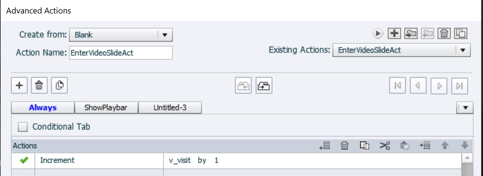

    That was the code.  OK, will put it in the Advanced Actions dialog box.

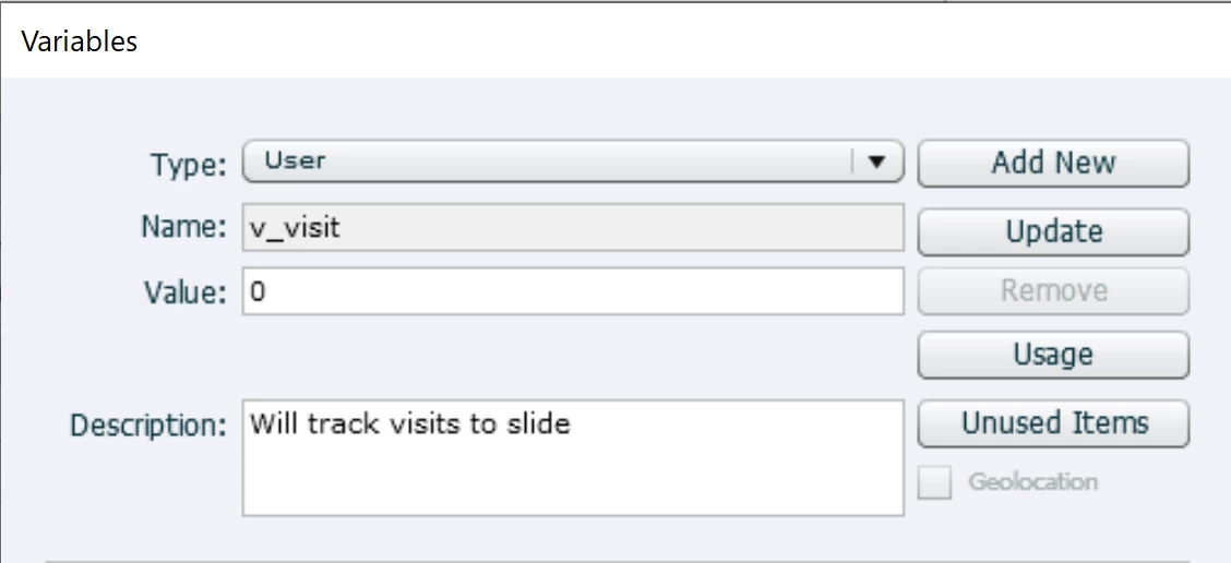

    • Define user variable v_visit

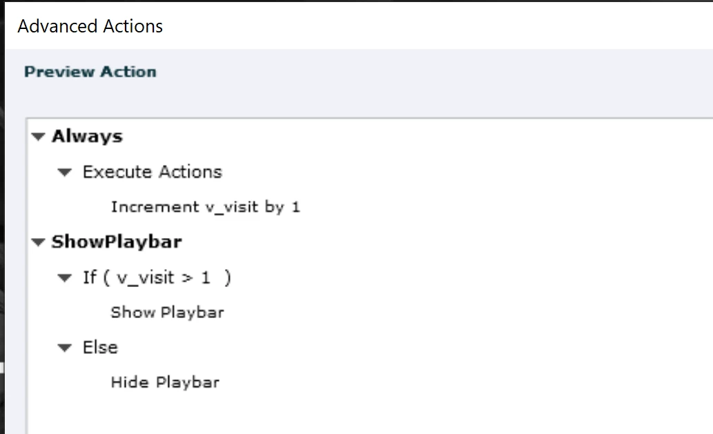

    • Create this advanced action:
    • Above is the Preview, in the dialog box it looks like this for the first decision:
    • For the Second decision, THEN part:
      and ELSE part:

    To achieve what you want, you need to insert as Slide video. You will have to extend the slide duration to the duration of the video clip. Then you can add an action On Enter to show or hide the default playbar in Captivate. That action can be based on checking a user variable, which I will label v_visit. It would store the number of visits to that slide. If it is the first visit, the playbar should be hidden, else it will be shown. You need to increment the variable v_visit, which can also be done in that same action. If you need more info, let me know.
