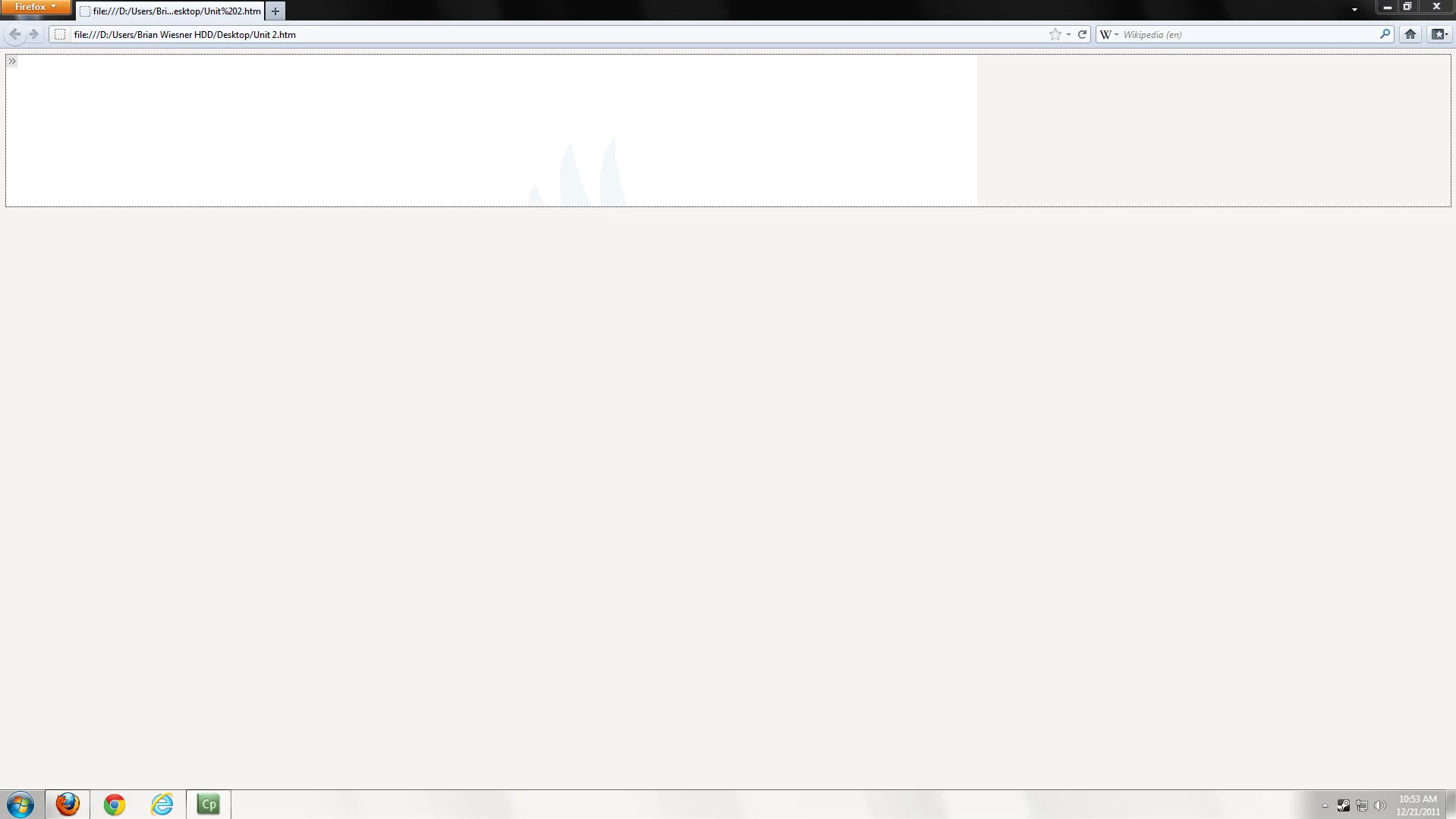

I upload all three files. Here is what the first frame of the video normally looks like, for reference:
Based on what you said, I opened the HTML file in Notepad and changed...
          var so = new SWFObject("Unit 2.swf", "Captivate", "1281", "985", "10", "#CCCCCC");
to...
          var so = new SWFObject("Unit 2.swf", "Captivate", "100%", "100%", "10", "#CCCCCC");
When I did that, the first slide looked like this:
...and changing the size of the window doesn't affect the size of the video. Any idea why this is happening?

Disregard the last message. I followed these instructions, written by Jim:
http://captivatedev.com/2011/08/28/scaling-adobe-captivate-content-across-browsers/
...and now the results all look like the first pic above, but they still don't resize at all. Here's the entire new HTML script:
